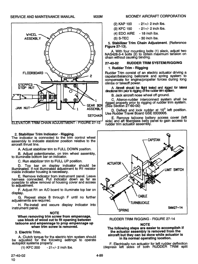

Rick Junkin Posted April 27 Report Posted April 27 On 4/21/2025 at 10:20 PM, warrenehc said: Hello, I just had avionics work done and my elevator trim position sensor is not normal. When going the full range of the trim it only goes done to the top of the TO setting and all the way to the full up position. Where is the sensor located to adjust back to show full trim travel @warrenehc The procedure for adjusting the electronic trim indicator is in the M20M service & maintenance manual. It's a somewhat laborious and iterative process best done with two people. You'll need to drop the belly panel to get to the trim potentiometer for the "down" adjustment, and pull the indicator out of the panel and open it up for the "up" adjustment. Here's a screenshot of the pages from the SMM with the instructions on how to go about it. The info specific to the trim indicator are on the second page, paragraph #2. 1
