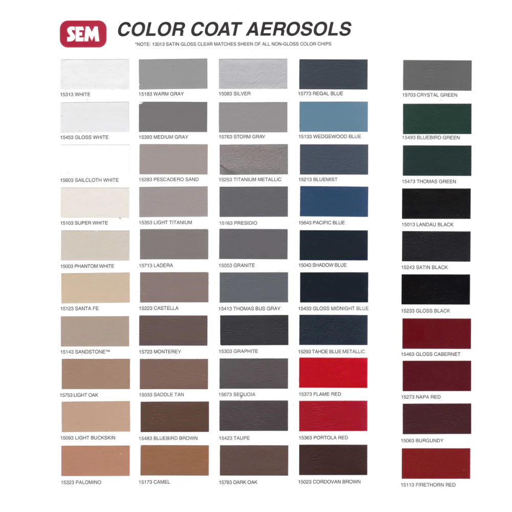

PT20J Posted September 7, 2022 Report Posted September 7, 2022 4 minutes ago, DCarlton said: Agree many use ABS glue but the plastic bonder I used bonded really well. What I liked was the working time and the fact that it can be easily sanded after it hardens. Sanding to finish makes for a great repair. So far it hasn't been brittle. I was even able to glue some nut plates to the back of the plastic side panels. The stuff stuck! I used mesh tape in some areas and thin metal backing in others. https://www.mcmaster.com/nut-plates/nut-type~adhesive-mount/ I found ABS cement and fiberglass cloth work well for reinforcements. Agree that the two-part plastic epoxy products are better if you need to build up an area or fill in holes or a low spot. The nut plates are interesting. I just used Tinnermans taped with aluminum tape to the back side since I was putting it back together with sheet metal screws. SEM Color Coat Phantom White is a good match for painting the plastic panels after repair.
DCarlton Posted September 8, 2022 Report Posted September 8, 2022 2 hours ago, PT20J said: I found ABS cement and fiberglass cloth work well for reinforcements. Agree that the two-part plastic epoxy products are better if you need to build up an area or fill in holes or a low spot. The nut plates are interesting. I just used Tinnermans taped with aluminum tape to the back side since I was putting it back together with sheet metal screws. SEM Color Coat Phantom White is a good match for painting the plastic panels after repair. Had a couple of areas where Tinnermans wouldn't work well and I wanted to get away from pointy screws. Stumbled over the adhesive nut plates; pretty cool. The JB Weld plastic bonder is actually a two part urethane not an epoxy by definition; I'm hoping it won't get brittle over time. It was just convenient. I tried ABS cement and finally aborted. Phantom White is what I used too. 1
Hank Posted September 8, 2022 Report Posted September 8, 2022 1 hour ago, DCarlton said: Phantom White is what I used too. My interior is SEM Almond. Buy at least two cans; I bought a box of 6 cans at bulk price, and split it with a friend.
