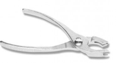

cnoe Posted May 19, 2017 Report Posted May 19, 2017 Some of them have a collar (probably not the right word) that is a separate piece. It also helps immensely to have the special pliers to install these (not expensive). If nobody chimes in soon I'll send you more info when back at my office this afternoon. They fall out typically when the holes become enlarged due to wear. There is supposed to be a retainer on them that could be missing but it's common for them to have this issue. Sent from my iPad using Tapatalk Quote

cnoe Posted May 20, 2017 Report Posted May 20, 2017 As Clarence noted the fasteners along the horizontal seam are flush-style 2700 series and the ones running from the bottom of each side vertically across the cowling top are 4000 series and will include an appropriate grommet. The special pliers are in fact the tool needed to install the 4200 fastener into the grommet as well as getting the 2700s into un-worn cowling holes. The 2700s use a flat split-washer to retain the unit. You put the fastener in the hole and then bend (twist) the washer open to install on the inside of the cowling before straightening it out again to lay flat (easy to do with a couple of needle-nose pliers). With the 4000s you install the grommet through the cowling and then install a thin spring-steel c-clip around it inside the cowling (to retain the grommet). The fastener is then placed in the special pliers and its shank fully extended so that you can insert the fastener through the grommet at an angle. The fasteners cannot fall out of the grommet, but if your holes are worn the grommets (along with the fasteners) may fall out. The fastener length is determined by the thickness of all the materials it passes through, and also by the amount of wear to the hole. Ideally the center stud should remain flush with the body when installed. This may require you to use 2-4 different length fasteners. Trial and error works well for this. Also, with the 4000 series you may be able to add a (very) thin teflon washer between the grommet and the cowling to stop or at least reduce wear in the fiberglass cowling (and aluminum backing). Also, there's another awesome company in Leesburg, Florida called Skybolt Aeromotive that has a complete line of Camloc equivalent/compatible fasteners that are super helpful, affordable, and excellent quality. I replaced all my Camlocs a couple of years ago with the SS Skybolts and couldn't be more pleased. Check out WWW.skybolt.com for more info. I'll attach their catalog .pdf for your reading enjoyment. Before and after pics attached as well. catalog-skyboltproduct.pdf Quote

epsalant Posted May 20, 2017 Author Report Posted May 20, 2017 15 hours ago, cnoe said: As Clarence noted the fasteners along the horizontal seam are flush-style 2700 series and the ones running from the bottom of each side vertically across the cowling top are 4000 series and will include an appropriate grommet. The special pliers are in fact the tool needed to install the 4200 fastener into the grommet as well as getting the 2700s into un-worn cowling holes. The 2700s use a flat split-washer to retain the unit. You put the fastener in the hole and then bend (twist) the washer open to install on the inside of the cowling before straightening it out again to lay flat (easy to do with a couple of needle-nose pliers). With the 4000s you install the grommet through the cowling and then install a thin spring-steel c-clip around it inside the cowling (to retain the grommet). The fastener is then placed in the special pliers and its shank fully extended so that you can insert the fastener through the grommet at an angle. The fasteners cannot fall out of the grommet, but if your holes are worn the grommets (along with the fasteners) may fall out. The fastener length is determined by the thickness of all the materials it passes through, and also by the amount of wear to the hole. Ideally the center stud should remain flush with the body when installed. This may require you to use 2-4 different length fasteners. Trial and error works well for this. Also, with the 4000 series you may be able to add a (very) thin teflon washer between the grommet and the cowling to stop or at least reduce wear in the fiberglass cowling (and aluminum backing). Also, there's another awesome company in Leesburg, Florida called Skybolt Aeromotive that has a complete line of Camloc equivalent/compatible fasteners that are super helpful, affordable, and excellent quality. I replaced all my Camlocs a couple of years ago with the SS Skybolts and couldn't be more pleased. Check out WWW.skybolt.com for more info. I'll attach their catalog .pdf for your reading enjoyment. Before and after pics attached as well. catalog-skyboltproduct.pdf It looks like we have different sized fasteners (diameter). Interestingly Aircraft Spruce sells kits only for J models until 1987, so there might have been a change then... I looked in the parts manual. Looks like I need grommets...is this the tool I need to attach grommet to stud ? The description that they give and other sites as well is very vague. https://www.aircraftspruce.com/catalog/hapages/camloctools3.php?clickkey=3026642 Quote
cnoe Posted May 21, 2017 Report Posted May 21, 2017 Yes, that tool lets you install the studs into the grommets. Sent from my iPad using Tapatalk Quote
