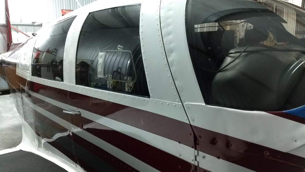

If you are on a August/September schedule the acrylic should stay warm. We did mine in Dec so I stored the panes with a ceramic heater keeping them toasty. Lots of holes to drill for a '66E, J's are different. Your F... probably gets holes all around side windows.
Yes Bob, I am a holy man. Even my 201 windshield is holy. Is your windshield screwed or riveted in? Send some close up photos of what it looks like after paint?
Sent from my iPad using Tapatalk Pro
If your windshield is like mine, a 201 windshield, the screws across the bottom do not go through the plexi. The aluminum across the front comes off, the plexi is inserted into a slot across the top and down the sides and the lower strip is reinstalled. That sentence simplifies quite a few hours of work removing the plexi - I finally took a ball peen hammer to mine - cleaning all the various old sealants and fitting/trimming/fitting/trimming/fitting the windshield. The proper sealant is a 2 part polymer.\
I don't find the close up pic you'd like. Here's  a couple of shots... pretty high res so you should be able to zoom in...
What is different on mine is there are screws all the way around the windshield. No rivets at all. My side windows as well are screwed in.
