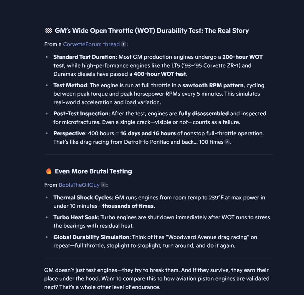

McMooney Posted September 24, 2025 Report Posted September 24, 2025 Still comparing apples to pretzels, in the example of a 5.0l engines, io360 and that dog of a ford mentioned earlier io-360-a1a -- 5l engine -- RATED at 200hp@2700rpm and most likely limited by prop i believe the helicopte version is rated higher dogford -- 4.8l engine -- RATED at 400+hp@5000rpm -- i don't know what rpm just an example the rating is a point on set by the manufacturer which is different between the applications. i believe a better comparison is how long can they both put out 200hp, or how long can they both put out 75%, 65% WOT is rarely even the 100% rating in the airplane unless you're flying on a cold day @ sea level and 59ish deg

McMooney Posted September 24, 2025 Report Posted September 24, 2025 so as a youngster i remember seeing a presentation on gm engine durability testing. I can't find the video online anymore but here's AI's abstract of what they do. this is only a portion of the things i remember them doing, wish i could find the original video 1 1
