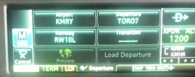

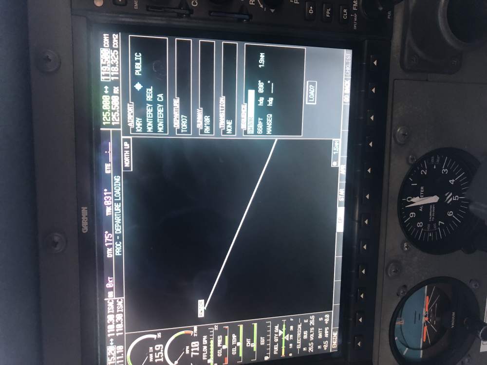

Just finally remembered to try this on the g1000 while my student taxied in. It shows no transitions as expected. The 375 makes you pick a vor nearby as the transition which didn’t match the clearance id been given. Both systems are current on database so I guess they are just different. In the 375 you cannot load the procedure without selecting a transition.
Yes, I have the same issue sometimes and it often occurs when you’re given a SID or STAR clearance while already “inside” the geographical boundaries of the procedure so it makes no sense to fly to a transition.  You can usually pick any transition and then go direct to the waypoint that was the one they gave you in the clearance.
Transitions for stars and sids as well as airways are  ore often than not fickle on the legacy g1000.
the nxi had none of these challenges.
