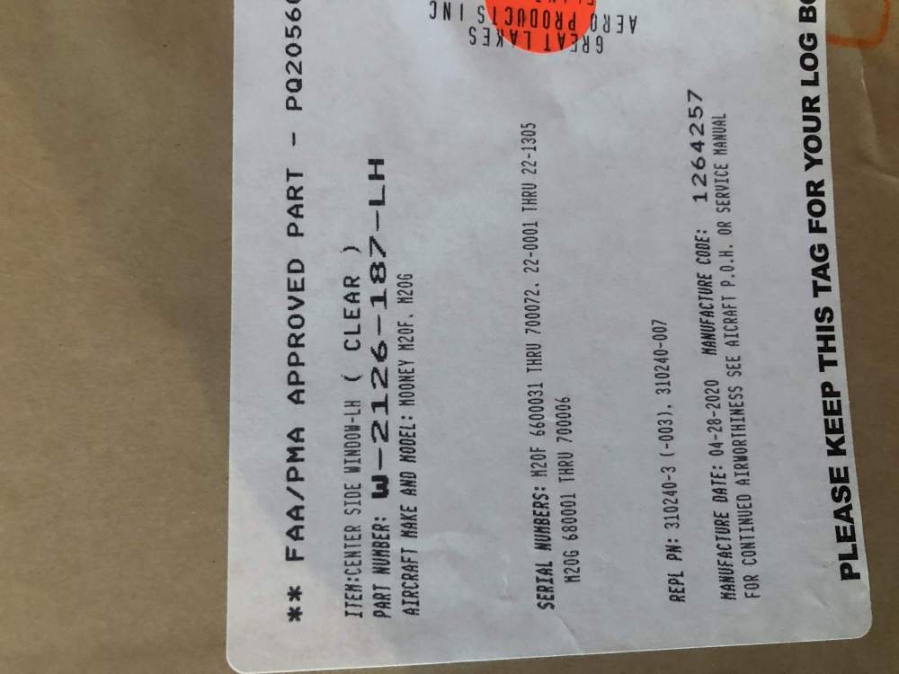

So, finally managed to wrestle my AME away from other personal commitments, and began installing my new windows from GLAP. Two hours in, and we had the front, pilot and door windows off.
After having to disappear for some work commitments, I came back and helped with the remainder of the back windows.
That’s when I noticed the unfortunate..... the rear “tinted” windows were shipped to me clear!
Aside from the $140 overcharge that I now need to recoup, I now have all clear glass throughout the aircraft.
Question is: Has anyone tried tinting windows after installation? Wondering if this will be worth the trouble? I discovered the mistake 10 minutes after GLAP closed today, which means I can’t discuss how long it’ll take to send me the proper windows (original estimate On the primary order was 8 business days), and I don’t want to wait until Monday to find out. So, the clear windows are going in.
If it’s like car window tinting, will I get a ticket from an overbearing Cop? (JOKING) But seriously, if it’s the same procedure as glass and acrylic, should I try and get GLAP to foot the bill for their mistake?
I doubt they will do anything but refund the difference (clear vs tinted). @Skates97 has a detail article on using tint on plexi, might try and find that to help you out
