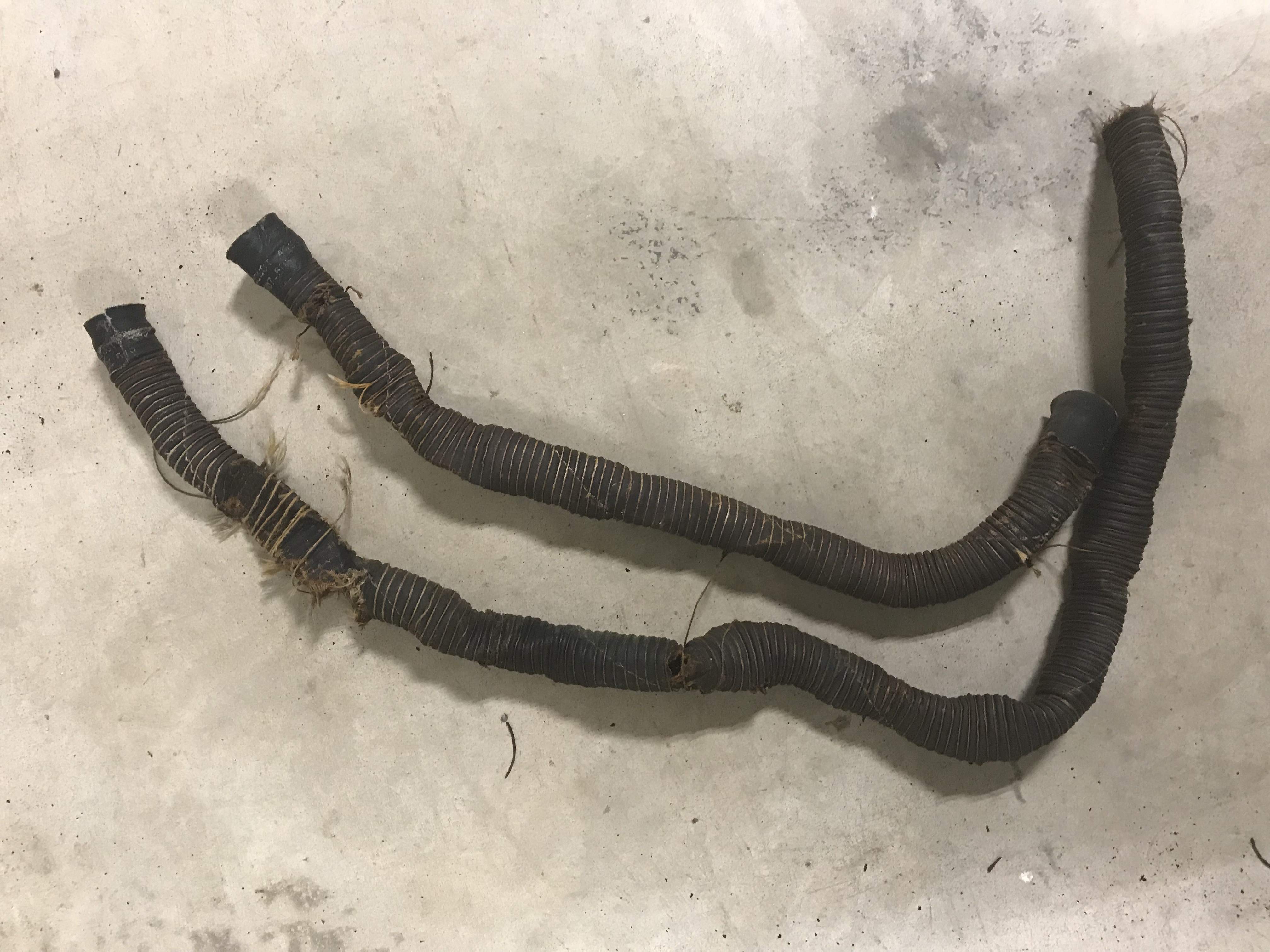

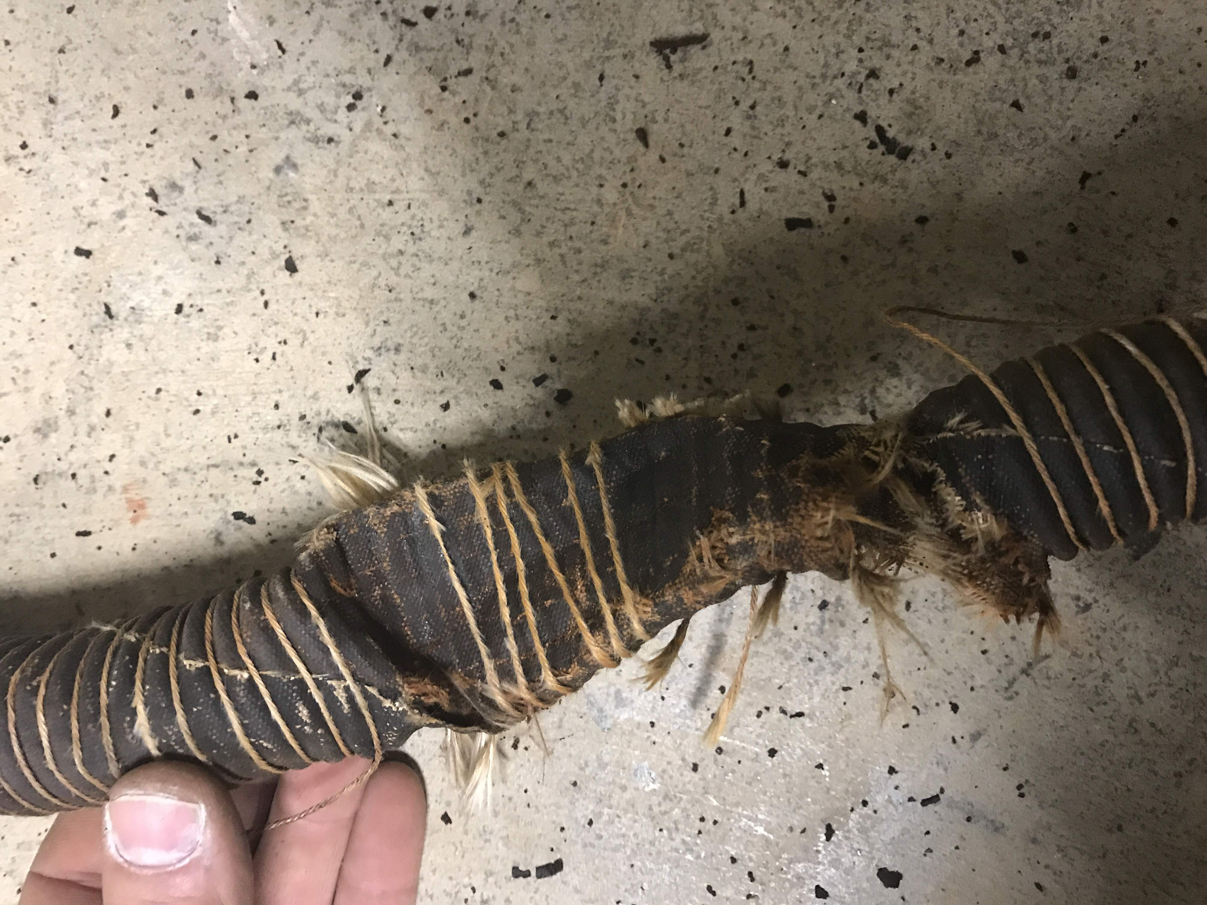

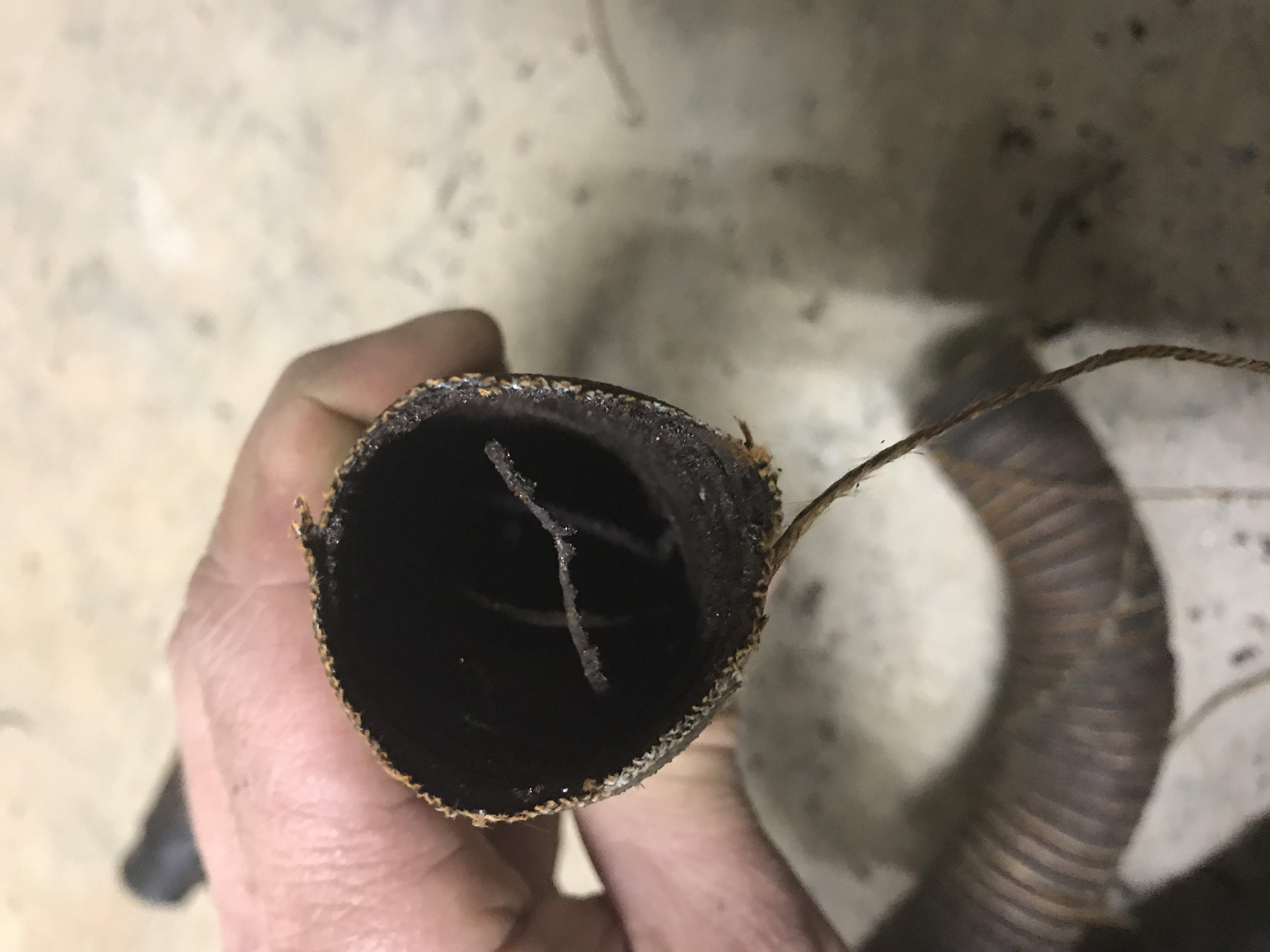

Culver LFA Posted February 20, 2019 Report Posted February 20, 2019 Not expecting a miracle here but I think I figured out why my defroster hasn’t worked since 1982... Half the hose material is still in the airplane, I’ll have to remove that debris with the shop vac!

Culver LFA Posted February 20, 2019 Author Report Posted February 20, 2019 11 minutes ago, carusoam said: There are a few of those hoses all the way back to the seats in the back... Buy enough to change out the 9 yards... Go upscale material so you only have to do it once... orangey silicone? Best regards, -a- Hmm, I’ll have to check that out. I haven’t seen any hoses to the back? It’s on the jacks now with all the interior and exterior panels off, where are they routed? If I could get heat to the backseat my wife would be very happy! I’m replacing everything with orange sceet, those go on sooo nice.
Immelman Posted February 20, 2019 Report Posted February 20, 2019 (edited) My ducting looked very similar. Go through it all, you'll be glad to did. The SCEET tubing (orange, double wall) is a worthwhile upgrade... bit more $$ per foot than SCAT (orange, single-wall) but it will carry the heat better, and goes on easier. The hoses to the back on mine (66E) start at the junction box in each front seat footwell, and go behind the side panels, emerging at the rear seat passengers' feet. Its not a perfect system... if you open the front seat footwell vents, you're robbing some air to the back. But my back vents barely worked in any case, and now after replacing the tubing I can direct a lot of air and heat back there if I want to. Edited February 20, 2019 by Immelman
