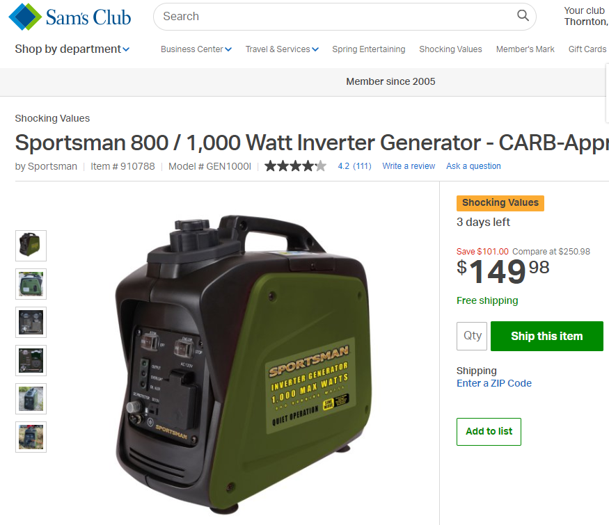

Sams club and Home Depot both have the Sportsman Generators on sale (Sam's club only until March 29, 2019) if anyone missed the last rush at Home Depot.
