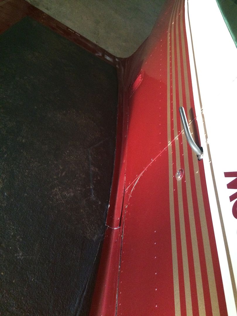

rbridges Posted January 12, 2016 Report Posted January 12, 2016 the leading edge came loose a few months ago. I figured no big deal, but it seems to be getting worse. I guess the wind is getting under it and pulling. I sent my IA a text, but I was wondering in the meantime if it's hard to fix. It looks like the fastener separated. Not really sure how it engages.

Yetti Posted January 13, 2016 Report Posted January 13, 2016 At least the leading edge and trailing edge are held on with #4 screws. They are backed up on the inside with a speed nut. You could probably remove the interior side panel to get to those. I think the leading and trailing edge may need the bottom panels removed. Stainless seems appropriate to keep it from reoccurring. I think stainless will add .000004 knots per screw replaced

Shadrach Posted January 13, 2016 Report Posted January 13, 2016 (edited) Yetti has it right. That fairing is held in place with #4 screws with tinnerman nuts on the backside. If the nut is no longer there, you will need to remove the corresponding interior piece to fasten it properly. Edited January 13, 2016 by Shadrach 1

Shadrach Posted January 13, 2016 Report Posted January 13, 2016 thanks guys. this was a huge help! Rob, In looking at your pic, it appears as though the screw has a fair amount of paint on the head and is still in place; this means the tinnerman nut's gone missing or the screw is broken (likely). You may be able to fasten it from the back side, if not, you're going to need to "cut" the screw out.
Yetti Posted January 13, 2016 Report Posted January 13, 2016 "Broken" a nice way to say corrosion has eaten away the screw. metal screws with aluminum skin with paint stripper. galvanic corrosion .... You should probably have more than one #4 screw and several speed nuts ready. Depending you may have to go up to a #6

rbridges Posted January 13, 2016 Author Report Posted January 13, 2016 Rob, In looking at your pic, it appears as though the screw has a fair amount of paint on the head and is still in place; this means the tinnerman nut's gone missing or the screw is broken (likely). You may be able to fasten it from the back side, if not, you're going to need to "cut" the screw out. I'm going to peel the paint away and see if the head is still there. Hopefully it's intact so I can remove it easier.
rbridges Posted January 13, 2016 Author Report Posted January 13, 2016 10 hours ago, Shadrach said: Rob, In looking at your pic, it appears as though the screw has a fair amount of paint on the head and is still in place; this means the tinnerman nut's gone missing or the screw is broken (likely). You may be able to fasten it from the back side, if not, you're going to need to "cut" the screw out. you called it right.
