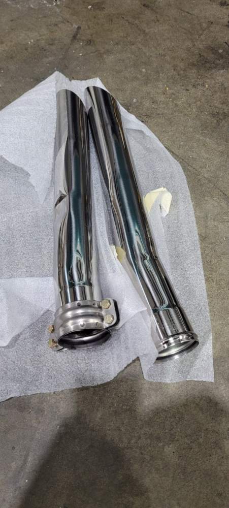

Gee Bee Aeroproducts Posted January 7 Report Posted January 7 On 1/4/2026 at 8:24 AM, hnorber said: Hello - wondering if anyone has a link to a helpful guide on replacing the tailpipe on an M20J? (1991 Model - MSE, in case it makes a difference). Thanks. I would like your old assy ? I want to duplicate in CP2 titanium cheers i have completed several projects for different mfg"s 2
KSMooniac Posted January 7 Report Posted January 7 Guy, would you permanently need a part/system to duplicate, or just a loan? ie is it a destructive process on your end? I'm replacing Knisley system on my J very soon with a Power Flow, and once I'm satisfied with the performance I'll very likely sell my old system. I believe it does use a stock/standard tail pipe. I'd happily loan you my take-off system for as long as you need it so long as I can have it back to sell.
Gee Bee Aeroproducts Posted January 7 Report Posted January 7 Pics to start please n77gb@msn.com Tailpipe
Gee Bee Aeroproducts Posted January 9 Report Posted January 9 If you need different ducts for the power flow system let me know
