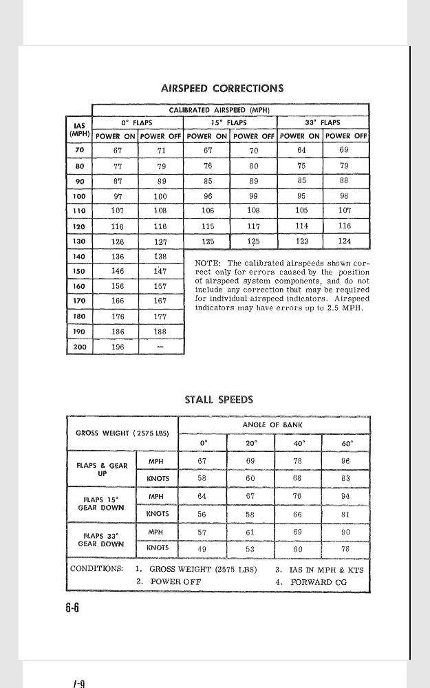

Hank Posted Wednesday at 09:20 PM Report Posted Wednesday at 09:20 PM @ptwffz, I've attached the relevant page from the Owners Manual for myn1970 C, but there were many changes made from 1964-1970. Do you have a similar page? There are additional Owners Manuals available in the Downloads section, you maynfindnine for a C with this information from a year closer to yours; I think I've seen a 1965 book there. P.S.--Pay attention to the offset note under the Airspeed Corrections table.

ptwffz Posted Wednesday at 10:17 PM Author Report Posted Wednesday at 10:17 PM Thanks for the charts Hank and Hammdo. Hank, I do not have that page in my POH. I do have Hammdo's page. I guess I'll have to interpolate the numbers to see if there's any hope. My POH shows stall speed clean at 67 mph IAS and bottom of the green arc at 70 mph CAS. It's interesting that 70 IAS MPH (bottom of green arc) translates to 67 CAS MPH with power on with your chart Hank. That would take me at 58 KCAS bringing me just below the 59 KCAS or lower requirement. But it's with power on and I don't see MOSAIC specifying power on or off speeds. Loophole? Who knows.

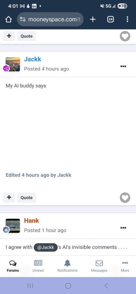

Jackk Posted Thursday at 05:19 PM Report Posted Thursday at 05:19 PM (edited) My AI buddy says “58 KCAS (67 MPH × 0.868976 = 58.22 knots; IAS ≈ CAS at low speeds, rounded to whole knot per aviation convention” Edited Thursday at 05:24 PM by Jackk
Hank Posted Thursday at 08:30 PM Report Posted Thursday at 08:30 PM I agree with @Jackk's AI's invisible comments . . . . 1 1
ptwffz Posted Thursday at 09:18 PM Author Report Posted Thursday at 09:18 PM I won't continue to harp on this subject. One last thing. My Owners Manual says bottom of green arc is 70 mph calibrated and my stall speed is 67 mph IAS. If true, then there must be a 3 mph increase from IAS to CAS. Hank shows a chart showing a 70 mph IAS corrected to 67 mph CAS with his 1970 C. How is it that possible? One increasing by 3 mph and the other decreasing by 3 mph. Can the installation error be that far off?
Jackk Posted Thursday at 10:00 PM Report Posted Thursday at 10:00 PM 1 hour ago, Hank said: I agree with @Jackk's AI's invisible comments . . . . my copy paste not work?
Hank Posted Thursday at 10:04 PM Report Posted Thursday at 10:04 PM 57 minutes ago, ptwffz said: ??? To read what he wrote, I have to select a random spot and click on "Select all". Otherwise it's just invisible writing.
