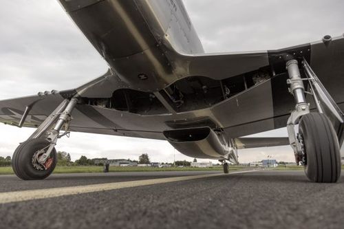

EricJ Posted September 21 Report Posted September 21 18 minutes ago, 1980Mooney said: Check out the drag inducing radiator on this Kawasaki concept. The good news it can double as a belly saver during gear-ups! Kawasaki Aero Piston Engine | Kawasaki Motors, Ltd. If the engine is making enough heat, that type of cooler can produce enough thrust to cancel the drag it creates, so you wind up getting the cooler for free. Liquid cooling does add maintenance, weight and and additional failure modes, though.

Jackk Posted September 22 Report Posted September 22 8 hours ago, 1980Mooney said: Check out the drag inducing radiator on this Kawasaki concept. The good news it can double as a belly saver during gear-ups! Kawasaki Aero Piston Engine | Kawasaki Motors, Ltd. Uhh 1 1

Rick Junkin Posted September 22 Report Posted September 22 6 hours ago, Jackk said: Uhh Those apples have engines rated in thousands of horsepower. Our oranges have engines rated in hundreds. Commensurate order of magnitude reduction in intake size might be comparable, like what is used on the Rotax applications. Thanks for the pics though 2
