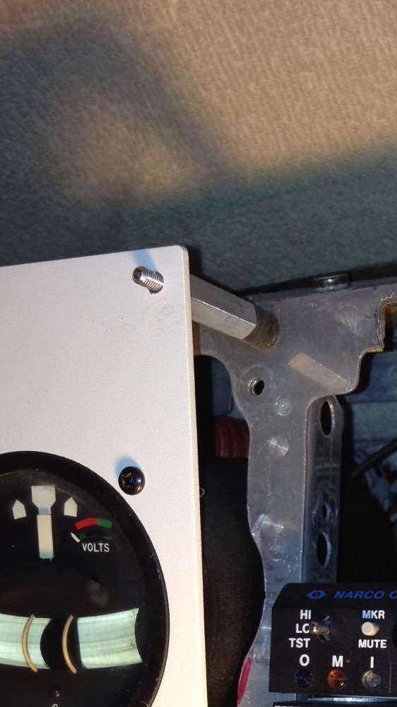

So while the engine, motor mount, nose gear, control cables, and flap actuator are all out, I decided that since I've already dug a massive hole...why not keep digging?
I'd like to start work on two more things:
1. Replace the co-pilot panel
2.  Install an ADSB equipped Transponder
See the current state of the panel below.  Note the EDM-730 in the top right.  I put it there to quickly get me back in the air with plans to clean things up later...well...the engine is out for at least another month so I might as well do it now.  There is also a TB instrument in the glove box...useless there.
I also need a transponder and so I might as well go with ADSB.  I'm leaning towards getting a GARMIN GTX 335 ADS-B TRANSPONDER WITH GPS + GAE 12 ENCODER / MULTI CHARGER PROMO KIT FOR CERTIFIED AIRCRAFT.  I don't know much about Avionics... would you agree this is a good one for me?
My overall plan:
  1. Keep the RPM and Manf/fuel gages in their current location.  I like the steam gages and they work fine.
  2. Shift the 730 over to the left top so it is closer.  Remove the engine monitor warning light for now and move it to Pilot side later.
  3. Put the transponder right below it to save space in the middle stack for a GPS at a later date.
  4. Put the Audio Panel to the right of the EDM
  5. Put USB plugs somewhere or keep cigarette lighters. (the latter is easier since both are already wired and ready to go.
  6. Maybe put an i-Pad mount in the open space that this has created.  Or put a really cool Mooney Logo and drop the needed placards (I think many are missing) over here.
  7. Put all the add on breakers above the factor breaker location (You can see several in the glove box area, what you maybe did notice is a couple of rouge ones on the right side in random locations.)
  8. Some day I'll re-do the pilot panel, move the TB over to the pilot side at that time, replace the Narco radio with another KX so it's smaller, and insert a GPS unit in the stack to move back towards IFR capabiltiy.
My plan is to have a local shop cut the co-pilot panel for me, however, I don't have good resources for making my own engineering drawings (Even though I'm an engineer)... My day job company uses Creo (Pro-E) and I no longer need the software in my current role so I don't have it any longer.  My main home PC is a MacBook, but I do have an older laptop that can maybe run Solidworks.
I think the easiest route for me is to use the EAA provided Solidworks.  Does anyone have the SolidWorks cad file to get me started? Much of it I could measure, however, the upper right portion of the panel isn't easy to define since is a sweeping curve.  Hopefully one of you have already plotted this out.
Or... maybe I can contract one of you to make the CAD file for me?
Lastly... I'm not sure what I would need to do to mount the Transponder case.  I think it needs to screw in from the sides at the panel so I'd need provisions for this behind the panel but I'm not sure.  Thoughts on this?
I figure if I start with this it will be a trial run for doing the pilot side later.
Thanks for your help and guidance!

Here you can see the middle stack.  The Narco radio is quite large.  In the bottom there was a DME...it was stolen before I bought the plane.  I removed the tray last weekend to make it easier to get to the control cables.  So I have wires ready to go for the transponder!
I’d put transponder over on the right, it’s usually only manipulated either on the ground or in stable flight, no need to be handy in the center stack and move JPI over so that it’s in your scan.
