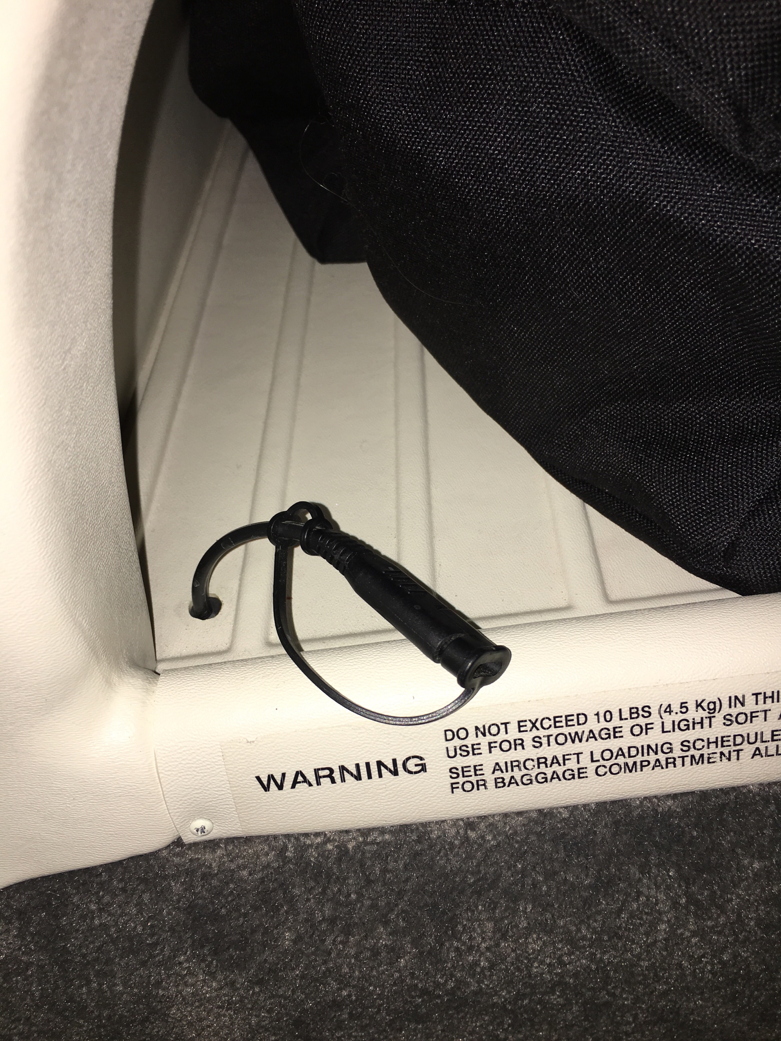

carusoam Posted February 23, 2017 Report Posted February 23, 2017 (edited) Thanks for sharing all the details, AggieP. definitely put the battery test on the pre-flight check list. The list usually says test both batteries, and then start on the stronger of the two... The JPI has a voltage gauge that reads to a decimal place. Once the engine is running, the voltage reading is going to be driven by the alternator... Battery selector solenoid have a tendency to wear. If you push it slowly you can get it to turn everything off before it switches to the next battery. I have two identical batteries. They get switched every day. I would prefer to do that prior to engine start than mid flight... +1 on the BatteryMinder. TomK, where is your BatteryMinder connection? I have recently acquired a BatteryMinder and thinking where to run the cord to avoid opening the access panels each time... Best regards, -a- Edited February 23, 2017 by carusoam
aggiepilot04 Posted February 23, 2017 Author Report Posted February 23, 2017 While I'm still at the hangar, here's where mine is. I actually don't have the batteryminder (it's on my list)...just the wiring. And it appears to only be wired to batt 1.Sent from my iPhone using Tapatalk
aggiepilot04 Posted February 23, 2017 Author Report Posted February 23, 2017 Sent from my iPhone using Tapatalk
carusoam Posted February 23, 2017 Report Posted February 23, 2017 The battery minder people sell a few additional devices... There is a specific Y for the two battery system with fuses included, incase something goes wrong. There are wires with rings that mount to each battery. The Y mates up directly to these. i also saw a socket they have that would improve the look of the wire coming through the hole. I'm starting to consider the plug mounted through the vertical wall in the area that you are showing there. Open the baggage door and plug in... Others have mentioned running the cord out around the ground power service area. Not sure of the details on that without looking closer. Best regards, -a-
LANCECASPER Posted February 23, 2017 Report Posted February 23, 2017 The Batteryminder part number for the Y is 210-AY (http://www.ebay.com/itm/BatteryMINDer-SmarTECHnology-Y-Multiple-Battery-Connector-Model-210AY-New-/381932099068?hash=item58eced55fc:g:1uoAAOSwLEtYgyd8) that stays in the avionics bay in the back. I ran mine out the Oxygen door. Both batteries stay desulfated and charged with one Batteryminder for Concordes (http://www.aircraftspruce.com/catalog/elpages/batteryminder11-14352.php?clickkey=2300274)
