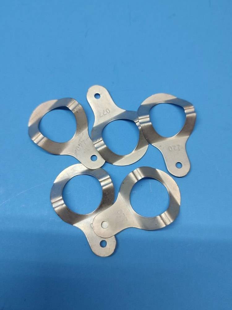

Montreal Posted April 18, 2025 Report Posted April 18, 2025 Does anyone have tips for re-installing the pushrod shroud tube springs on Lycoming IO-360A1A? New seals and springs, difficult to engage spring with tube and seals installed. Attached photo of shroud spring. Thanks in advance.
N201MKTurbo Posted April 18, 2025 Report Posted April 18, 2025 It takes bad words and blood. if you coat the seals with DC4 you can get them to snap in pointed up and them rotate them where you like. Put a little DC4 on the spring and tube and the spring will rotate into place easier. If you put a 6” loop of lock wire through the hole, you can slide a screwdriver through the loop and have a good handle to pull on. 1 1
Nico1 Posted April 18, 2025 Report Posted April 18, 2025 4 hours ago, N201MKTurbo said: It takes bad words and blood. So true!
BillyT0020 Posted April 18, 2025 Report Posted April 18, 2025 Had good luck setting them in place, then rotating the whole shroud with light taps on a flathead screwdriver on up against the protruding part on the outside of the shroud. 1
Jim F Posted April 20, 2025 Report Posted April 20, 2025 On 4/18/2025 at 7:50 AM, Montreal said: Does anyone have tips for re-installing the pushrod shroud tube springs on Lycoming IO-360A1A? New seals and springs, difficult to engage spring with tube and seals installed. Attached photo of shroud spring. Thanks in advance. You can use a J-hook pic or a small diameter door hook
MB65E Posted April 20, 2025 Report Posted April 20, 2025 .040 safety wire doubled up. Then pull them with safety wire Pliers. The aluminum pushrod tube is super soft. You’ll puncture or damage the ends if you pry on them. -Matt 1
Montreal Posted April 22, 2025 Author Report Posted April 22, 2025 Follow up... @N201MKTurbo thank you. Technique worked nicely. 1
