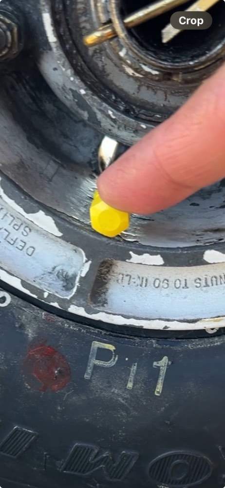

Dotto Posted May 2, 2021 Report Posted May 2, 2021 Hi all. I found straight stemmed inner tubes on my new to me 1962 M20C. I saw that others had questions on stem angles prior to me replacing mine so I attached the photos of the straight and 70* stems.
RLCarter Posted May 2, 2021 Report Posted May 2, 2021 Yep, there was a discussion on these a few months back. The straight rubber stems fail doe to being in a constant bind, 90° metal stem set too close the wheel. Both make it a PITA to service, 70° stems solves these issues.

outermarker Posted April 29 Report Posted April 29 So, what tire and tube resolved this issue? Was a tube with an angle used, and does that tube hold air throughout the year? I'm asking because it is time for me to change my tires and tubes. I, too, have straight stems and live in fear of ruining the inner tube by pulling the stem away to check and apply air. Goodyear FS III has been on it since I bought it, and I'll assume the inner tube is also a Goodyear. The FS III is the only tire using Kevlar and has a speed rating of 160mph. Currently, a Goodyear FS III and tube are over $500; therefore, spending around $1500 for three tires and tubes and then the labor costs is a bit steep for the shallow pockets I wear. I have a lightweight, short-bodied E. A perfect scenario for me would have these elements. Inner tube: 1. the tube holds air throughout the year without leaking. 2. the valve stem with the metal cap on doesn't rub, lie against, or interfere with anything. Tire: 1. easy to balance or balancing is not required 2. good tread depth 3. resistant to dry rot or cracking after a few years Is there a tire and tube that meets all of the above? Surely there have to be people out there who are overjoyed with their tires and tubes AND happy with the price paid for the tires and tubes. I would really like to hear from you. thanks!
Andy95W Posted April 29 Report Posted April 29 We just talked about this a little bit ago. You’ll see links for the inner tubes with 70° stems that are made of the same rubber as the Michelin Airstop tubes. Also, you can send a message to Jim Peace and ask him what he bought.

outermarker Posted May 4 Report Posted May 4 Today I attempted to install a new LEAKGUARD tube with 70 degree stem on the main rim. The new tube has about a 1/4” of rubber at the stem base that has to seat through the stem hole on the rim. I could not get the rim mounted onto the tire and the valve completely through and seated into the stem hole. I gave up completely defeated. What’s the secret?
Jim Peace Posted May 4 Report Posted May 4 6 hours ago, outermarker said: Today I attempted to install a new LEAKGUARD tube with 70 degree stem on the main rim. The new tube has about a 1/4” of rubber at the stem base that has to seat through the stem hole on the rim. I could not get the rim mounted onto the tire and the valve completely through and seated into the stem hole. I gave up completely defeated. What’s the secret? pictures of everything including wheels please
outermarker Posted May 11 Report Posted May 11 I don’t get an opportunity to give back and I’m so grateful to everyone who gives me help. This is an opportunity to perhaps help others. For those changing their tires and tubes I’ve enclosed a photo of the 70 degrees valve stem installed on the main tire. I used a Harbor Freight mini tire changer($56) to break the tire bead. Some hiccups I encountered. I wanted to use new bolts, washers and nuts on the rim halves. What I had was too long so additional washers were used. The bolt p/n in the Mooney parts manual was 1/8 too short. Also, the nut is a high temperature nut. Aircraft Spruce only has Nylock for that size. Nylock can be used on the nose wheel. What I learned was that I should have checked the Cleveland Parts Manual for the bolt length. So much for a DIY project! 1
