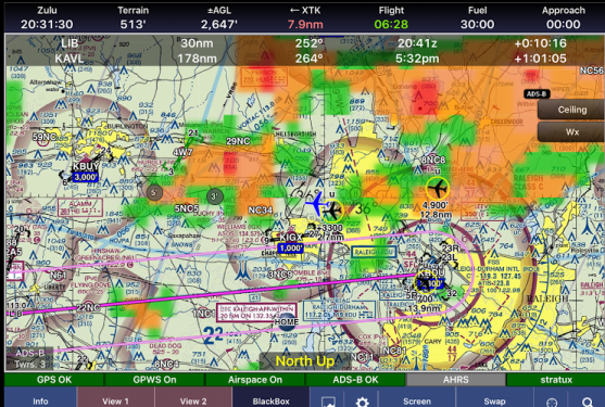

midlifeflyer Posted September 29, 2015 Report Posted September 29, 2015 Here's my experience from yesterday evening's flight. I was a passenger on a flight in a friend's airplane. He has a glass panel with XM and satellite, so good basis for comparison. I had the RY835AI GPS/AHRS add-on but it was connected by USB so GPS only. Use of GPS was part of my test since I have a WiFi-only iPad. iOS 9.0.1. Flight was about an hour or so each way. RPi was running the current beta 4 release. Plenty of weather around to see, Outbound, I used WingX. Absolutely rock solid. Connected immediately and stayed connected from startup to shut down. Weather and traffic depiction virtually identical to my friend's panel display. Some slight variation on number of towers being received based on antenna position but that's about it. Return. I used ForeFlight. Not quite the same. Took a few minutes for FF to recognize a device being there and, with the GPS/AHRS add-on, ultimately identified two devices one for the ADS-B and one for the GPS. Periodically lost connectivity. Display of weather and traffic was not as good as it was in WingX and not as consistently in alignment with my friend's panel equipment. I briefly fired up WingX also just to see, and it was as rock solid as before. Also, weirdly, FF reported the presence of AHRS and a switch to the synthetic vision page shows attitude reference coming on and switching off, when it shouldn't be there to begin with. Finally, the GPS capability crapped out about halfway home although ADS-B continues to function. I suspect I managed to overheat the chip on the RY835AI. Probably user error on the GPS chip but definite anomalies with ForeFlight as opposed to WingX. Leaves me wondering whether the developers haven't quite overcome FF's design to avoid playing well with non-Stratus units. But that's just a working hypothesis. 1
carusoam Posted September 29, 2015 Report Posted September 29, 2015 (edited) Great detailed user report, MLF. Expect that WingX has done a fantastic job of working with all platforms. At least that has been their mantra for the last few years... any idea what the yellow circles around the other planes means? Or is that an aid to see them on the busy screen? best regards, -a- Edited September 29, 2015 by carusoam
