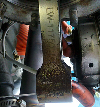

cujet Posted July 5, 2014 Report Posted July 5, 2014 As a mechanic, I still see a few Lycoming engines that are 40 years old, and seemingly airworthy (however, without disassembly, it's very difficult to know the actual internal condition) . My 200HP Lyc was installed in 1975 (or 74) and made it until 2007, when the camshaft finally failed. 1700+ hours since new. Upon disassembly of my engine, many parts were scrap due to corrosion. Including the cam, rods, gears and so on. If this is an aircraft for purchase, the engine needs to be considered "timed out" for pricing purposes. I'd bet a dollar that if the engine in question were disassembled, it would be in need of an overhaul. If only because there is internal corrosion on the connecting rods, crankshaft counterweights, camshaft bits, and possibly cylinder corrosion. Remember 12 years is the Lyc recommended overhaul period. 25 years is beyond double! Without proof the internals are perfect, the engine needs to be considered as timed out. Below is a pic of why time is a huge factor. Let's look at this another way. Our air cooled engines have plenty of combustion "blow by". This carries lead salts into the oil, as a byproduct of burning 100LL Avgas. Those lead salts are corrosive in nature. Couple that with the significant moisture created by combustion and the engines internals are bathed in a acidic corrosive mixture of water and lead salts. Oil change intervals and usage habits play a very large role in the corrosion equation. 25 years of low utilization significantly increases the possibility of internal corrosion. Quote

cujet Posted September 1, 2014 Report Posted September 1, 2014 Be aware that an engine can have a beautiful patina of rust on the connecting rods, crankshaft, accessory drive gear set, and other internal parts, yet still operate perfectly. And, it even may last for 30 additional years. Or that rusted connecting rod could snap on the next flight..... Put another way, how an engine runs is not an indicator of internal corrosion, with the exception of a completely worn out cam lobe or lifter. Lack of valve lift will reduce power! However, my engine with the cam lobe pictured below ran fairly well and performed darned close to normal at altitude. Quote
fantom Posted September 2, 2014 Report Posted September 2, 2014 ...However, my engine with the cam lobe pictured below ran fairly well and performed darned close to normal at altitude. Are you trying to dissuade 'rusty' mass hysteria and cost engine rebuilders lots of business? Good post! Quote
