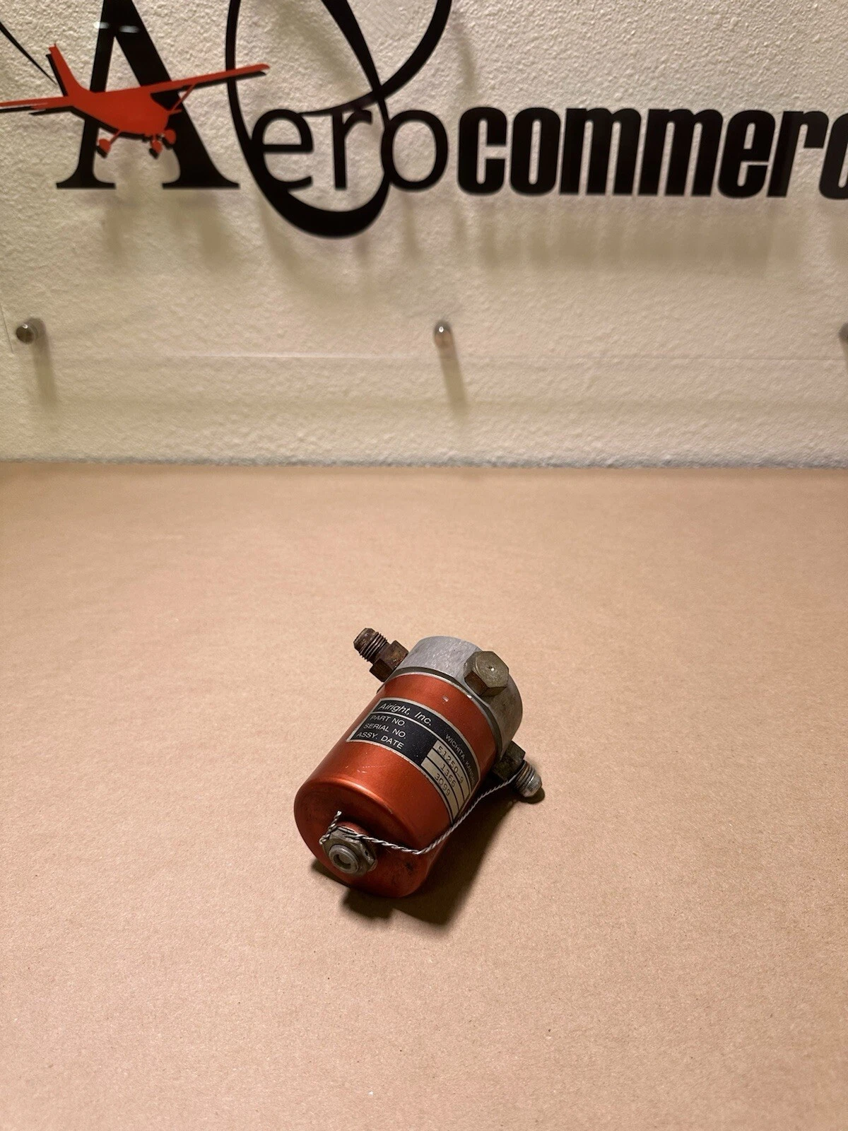

PT20J Posted March 15 Report Posted March 15 My 94 M20J has the 610015-001 gascolator. It's an Airight 51250-9 with a red can. The screen isn't flat; its a cylinder. See drawing attached. There's one listed on eBay for $69 obo described as for parts only. You could contact the seller and see if the screen is good if this is the one you need. https://www.ebay.com/itm/365014530937?_skw=airight+gascolator&itmmeta=01JPBHD6K87BFDGJ82M6691XPS&hash=item54fc8fbb79:g:NOgAAOSwofxmlrbp&itmprp=enc%3AAQAKAAAA8FkggFvd1GGDu0w3yXCmi1e8giZ%2Fo0Fmdx519imTQZxM8mY%2BgxLKR4ABUUt1Q3BIa%2BmiPO4GTjs0O0HZVBFkX0Gw9T2o52%2BT7ksDVvXiXZxgmDg7Z%2BI%2FnDSHaSF3ye%2BJ8%2FEcyh%2BXpQuEjS%2F7iRflZDqjiWzPlj0JfA8a0uy9jrZf2DvynXltw%2F%2BmD0aiVBPHHks5atZn0mY06bf8gDKJWbd%2BNztIlGelGnFECshWndxIHxCkB97w9RdXntgjnMuM91iQre2ewyohIndRG5bhMQ2ZvOqzoeSOe14H1NR620A70EV9MBTExC%2Fsx%2BsX5%2BW2jA%3D%3D|tkp%3ABk9SR8DqtPGyZQ Airight 51250-9 Gascolator.pdf Quote

PT20J Posted March 15 Report Posted March 15 If the screen isn’t torn, perhaps you could just straighten it. Otherwise the one on eBay might be serviceable. Quote
