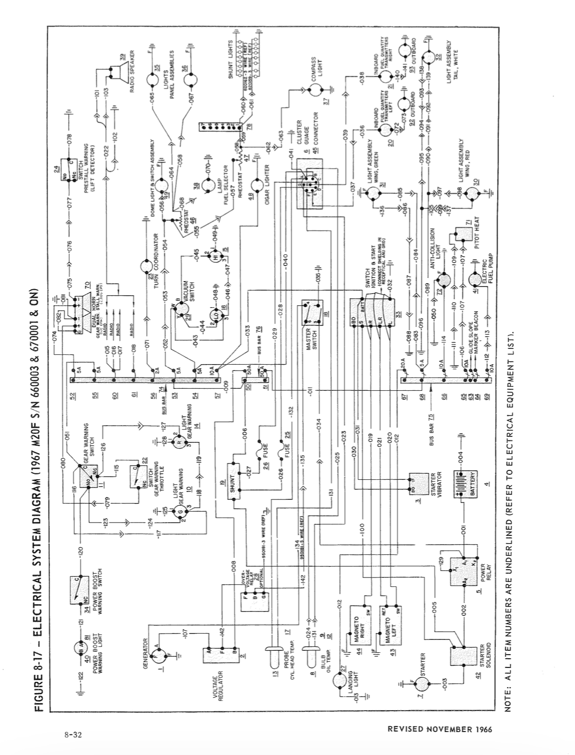

Guest Posted October 21, 2020 Report Posted October 21, 2020 Here’s the wiring schematic for your plane, it may be helpful. Clarence
