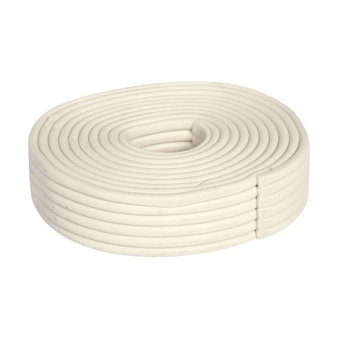

Shadrach Posted November 28, 2018 Report Posted November 28, 2018 21 minutes ago, Marauder said: Based on what I learned tonight, the Paramounts were used all the way to the early J models (through serial number 24-0763). The guy at Lasar just assumed I had the original Paramounts and sent me the kit for them. The owner before me was pretty meticulous on being more than proactive on things (like installing shoulder harnesses). The masters I have are on J models from SN 24-0764 THRU 24-3200 & 24-3202 THRU 24-3217. And what appears to be food particles on the reservoir is actually the fines from me scrapping all that excess RTV off of the flange. Sent from my iPhone using Tapatalk Pro I prefer rope caulk to RTV. It forms a nice seal but does not really adhere.
Marauder Posted November 28, 2018 Author Report Posted November 28, 2018 I prefer rope caulk to RTV. It forms a nice seal but does not really adhere. What can I say, I’m a glutton for punishment. Sent from my iPhone using Tapatalk Pro
Shadrach Posted November 28, 2018 Report Posted November 28, 2018 Just now, Marauder said: What can I say, I’m a glutton for punishment. Sent from my iPhone using Tapatalk Pro I'm sorry! I also just realized that I've never sealed up a SWTA panel. I know what the look like fully installed, but have no idea what your dealing with on the R&R.
Skates97 Posted November 28, 2018 Report Posted November 28, 2018 3 hours ago, carusoam said: Looks like reservoirs have changed quite a bit over the years as well... I was looking to see how the reservoir gets vented... 65 was a round aluminum container with a threaded plug for a cap? (Fuzzy memory) Also inside Firewall, easy to access from top access panel, when open at annual... Looks like Chris got a new carpet for the firewall, recently...? Reminder to check for the engine mount bolts, to make sure they don’t include the new carpet under the bolt heads... a known issue for newer planes built in the factory... they set the torque, then had them come loose over time as the carpet/insulation got flattened... Another reminder to ask Richard which brake fluid reservoir he has? @Skates97 Three options, Round rectangle Clear Best regards, -a- @Marauder, that tin can looks really sad. I went out to the airport for two things, one to get all the Christmas stuff out of the hangar for my wife to start putting it out when she gets back home tomorrow, and two so that I could take some pictures of things before the mechanics start trying to figure things out. Here is the reservoir in my plane. The blue plug is where you fill it (would make it impossible to overfill) and I am assuming the fitting on the top is to allow pressure out? I'll update a couple things in my other thread. 1
Marauder Posted November 28, 2018 Author Report Posted November 28, 2018 I'm sorry! I also just realized that I've never sealed up a SWTA panel. I know what the look like fully installed, but have no idea what your dealing with on the R&R. No problema. The SWTA panels are unique. When I first got the plane back in 1991, there was some sort of foam in the channel under the panel. That dried up over time and started flaking apart. Then came a series of attempts using various foams. Eventually leading to the usage of RTV since water could still get under the edges. Removing the RTV is not usually a tough thing to do. It essentially peels off but some of it does stick and requires some mechanical rubbing to get it off. Sent from my iPad using Tapatalk Pro
