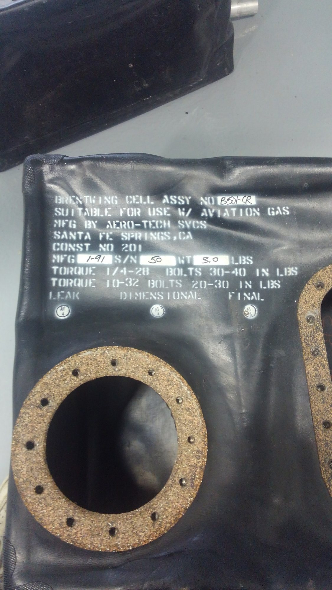

Dream to fly Posted April 15, 2018 Author Report Posted April 15, 2018 So today I removed the bladders with my AP. Not difficult as much as time consuming and a lot of deep breathing and meditation when following the destructive trail the previous owner AP left behind. This plane is just full of surprises and at least I have a sense of humor. The 6 bladders were installed in 1991 and look as good and are as soft as the day they were installed. The extension tanks were added in 2011 and look to be fine also. The problem was mostly installation error and sloppy careless blatant dis-regard for proper procedures. The leaks were coming from multiple places along with the drains, and the four sending units. Two of the bladders were leaking from the connection tubes. Not because of bladder failure but because ZIP TIES WERE USED to attach them to the tubes. I wasn't there when they were being installed but I sure the hell wish I was. I have a BAT that would have struck that idiot so hard he would have seen the 4 dimension in 3D. I'm sure they were installed properly in 1991 and the logs show no issues until 2011 when the extensions were installed by the previous owner. That is when the evidence is overwhelming. First the factory install from O&N use a green fuel tape that is very well applied and prevents the foam that cushions the bladders from moving. All the holes that the tubes pass thru have a plastic guard installed to prevent rubbing, The factory used these. Also any sharp edges or areas of concern were covered well from O&N. No questions they do/did great work!! Now where the issue comes in is where the 4th bag install caused all the problems. The previous owner used silver duct tape and foam from what looks like a pillow to protect the bladders. Where the tubes pass thru the spars he used rubber "garden" hose. Instead of using stainless steel ideal clamps he used auto clamps and zip ties. So for 20 years the original install was perfect. Let and idiot work his magic and seven years later it falls apart. TO fix this I am removing all bags and removing all silver duct tape and foam pillows. Installing all new correct foam and using the proper tape and grommets. Having already inspected the spar and the interior wings from all inspection holes there is ZERO evidence of corrosion or structural damage from 27 years of bladder usage. Plus one for bladders. Also the drains were supposed to have O-rings instead they had a sealant used. Basically it all was extension tank installation error. PS. How do you stop the pin from falling out of the door handle. You use green body shop tape to hold it in. That is what I am dealing with.... 3
Marauder Posted April 15, 2018 Report Posted April 15, 2018 So today I removed the bladders with my AP. Not difficult as much as time consuming and a lot of deep breathing and meditation when following the destructive trail the previous owner AP left behind. This plane is just full of surprises and at least I have a sense of humor. The 6 bladders were installed in 1991 and look as good and are as soft as the day they were installed. The extension tanks were added in 2011 and look to be fine also. The problem was mostly installation error and sloppy careless blatant dis-regard for proper procedures. The leaks were coming from multiple places along with the drains, and the four sending units. Two of the bladders were leaking from the connection tubes. Not because of bladder failure but because ZIP TIES WERE USED to attach them to the tubes. I wasn't there when they were being installed but I sure the hell wish I was. I have a BAT that would have struck that idiot so hard he would have seen the 4 dimension in 3D. I'm sure they were installed properly in 1991 and the logs show no issues until 2011 when the extensions were installed by the previous owner. That is when the evidence is overwhelming. First the factory install from O&N use a green fuel tape that is very well applied and prevents the foam that cushions the bladders from moving. All the holes that the tubes pass thru have a plastic guard installed to prevent rubbing, The factory used these. Also any sharp edges or areas of concern were covered well from O&N. No questions they do/did great work!! Now where the issue comes in is where the 4th bag install caused all the problems. The previous owner used silver duct tape and foam from what looks like a pillow to protect the bladders. Where the tubes pass thru the spars he used rubber "garden" hose. Instead of using stainless steel ideal clamps he used auto clamps and zip ties. So for 20 years the original install was perfect. Let and idiot work his magic and seven years later it falls apart. TO fix this I am removing all bags and removing all silver duct tape and foam pillows. Installing all new correct foam and using the proper tape and grommets. Having already inspected the spar and the interior wings from all inspection holes there is ZERO evidence of corrosion or structural damage from 27 years of bladder usage. Plus one for bladders. Also the drains were supposed to have O-rings instead they had a sealant used. Basically it all was extension tank installation error. PS. How do you stop the pin from falling out of the door handle. You use green body shop tape to hold it in. That is what I am dealing with.... Thanks for the update. Good to hear that it was not an O&N installation issue. Sent from my iPhone using Tapatalk Pro 1
Dream to fly Posted April 15, 2018 Author Report Posted April 15, 2018 All i can say is OMG. The worst is I had a pre buy done but what I thought was a reputable AP that owns a very busy FBO. Unfortunately this is the same company that in the end charged me 4200 dollar s to replace two oil lines and an oil cooler. It has been a very expensive learning lesson but now that I have a better understanding things will be right from here on out. At least the wing spar and the steel frame are clean. Everything else can be replaced. Sent from my E6810 using Tapatalk
