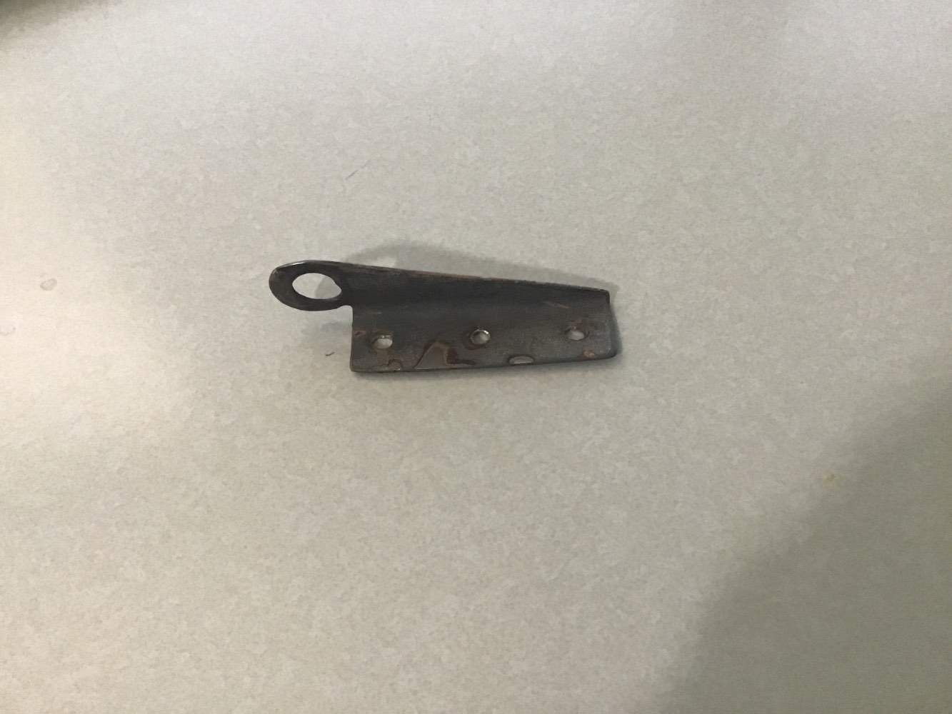

N201MKTurbo Posted November 17, 2025 Report Posted November 17, 2025 This is what the original hing looked like. They didn’t have the welded on bushing. You can see they are wallowed out. The SB had only been half complied with. The cowl flaps were replaced during a gear up repair before I owned it. So the cowl flaps were updated, but not the cowl side hinges.
