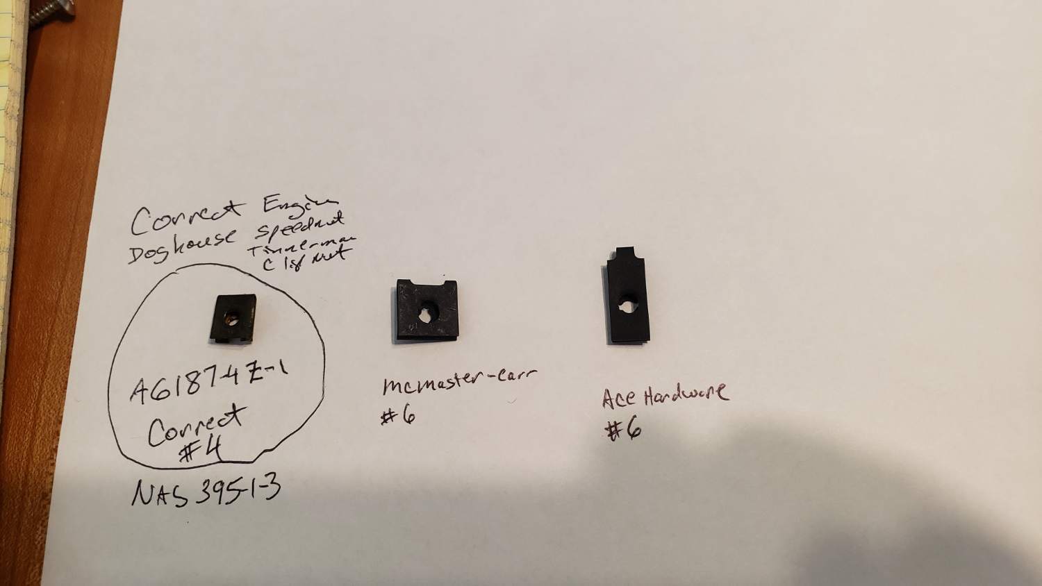

Hradec Posted May 16 Report Posted May 16 As my project is winding down I am putting together the doghouse. I can't find the correct original tinnerman speed/clip nuts. I have several missing and the rest are damaged. Manual calls out A6187-4z-1 aka NAS395-1-3 The original ones are very small and slim marked with a T-4z. Anybody come up with something that works well. I don't mind going up to #6. On the picture, the left one is the one that I suspect is original and correct. The middle and the right are the closest ones I could find. Thanks Glenn
47U Posted May 16 Report Posted May 16 33 minutes ago, Hradec said: Manual calls out A6187-4z-1 Spencer… https://spenceraircraft.com/a6187-4z-1-4-u-type-tinnerman-nut-olive-alt-part-94808a158.html 2

Hradec Posted May 17 Author Report Posted May 17 16 hours ago, 47U said: Spencer… https://spenceraircraft.com/a6187-4z-1-4-u-type-tinnerman-nut-olive-alt-part-94808a158.html I ordered these yesterday. I will see what shows up. Thanks 1

MB65E Posted May 17 Report Posted May 17 McMastercarr has the smaller clips. I have ordered from them in the past. -Matt
Hradec Posted May 17 Author Report Posted May 17 39 minutes ago, MB65E said: McMastercarr has the smaller clips. I have ordered from them in the past. -Matt Do you by any chance have the part number I ordered some from mcmaster carr and they were wrong

MB65E Posted May 18 Report Posted May 18 I don’t recall the McMaster Pn. But that’s where I grabbed them. Years ago… If Spencer’s has them that would be great. I thought they just did cheesy pilot supplies and such. Didn’t realize they have hardware too. I have one of their chairs and it’s Awesome!! -Matt 1

Hradec Posted May 24 Author Report Posted May 24 Just a follow up. Spencer aircraft did send me the correct small tinnermans for the doghouse. A6187-4z-1. Doghouse is back together! Thanks Glenn 1
