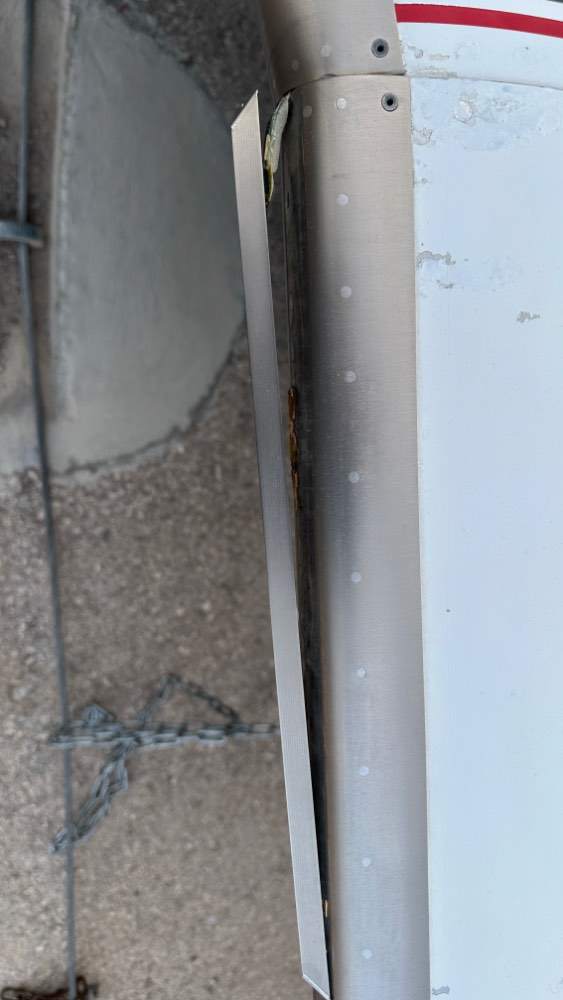

NickG Posted April 18 Report Posted April 18 UGH! Wind blew my cover off the top of the Ovation and it snagged on a loose stall strip and pulled it almost all the way off. Anyone have an idea what this repair should cost? Plane is AOG until I can get it fixed.
Bolter Posted April 18 Report Posted April 18 10 minutes ago, NickG said: UGH! Wind blew my cover off the top of the Ovation and it snagged on a loose stall strip and pulled it almost all the way off. Anyone have an idea what this repair should cost? Plane is AOG until I can get it fixed. At least you have the strip, and clear indications of the proper location. As I understand it, replace the internal foam if required, clean the surface well, apply the adhesive. I think the SB someone attached in this thread had the required steps. Put some speed tape on it now, to keep it from getting torn off more and overloading the fluid connection. 3
Fly Boomer Posted April 18 Report Posted April 18 11 hours ago, NickG said: Anyone have an idea what this repair should cost? Whoever does it needs to understand that the stall strip must be reinstalled precisely where it was. I doubt that a test pilot determined the location when the TKS was originally added, so that was the first opportunity to change your stall characteristics. Every time they are replaced, it's likely they don't get put back exactly where the Mooney test pilot put the originals. One way to memorialize the location is using tape well aft of the leading edge to indicate the lateral edge location, and more tape inboard and outboard to mark the vertical position. These tape markers must be in place before the old sealant is removed. The danger is that you end up on your back during a stall if the stall strips are misplaced.
mike_elliott Posted April 18 Report Posted April 18 12 hours ago, NickG said: UGH! Wind blew my cover off the top of the Ovation and it snagged on a loose stall strip and pulled it almost all the way off. Anyone have an idea what this repair should cost? Plane is AOG until I can get it fixed. shouldnt take an A$P more than an hr or 2 to fix. Your lucky, the hose didnt break off in the wing. As Dan said, tape that sucker up now, find an A&P who has done it before, it will go smooth. Enjoy a long lunch while glue sets up, and place another bet in vegas as this is your lucky day as the stall strip is not laying somewhere in the desert. Seems like Andy at CAV systems said at SNF they are $1500 new and they have a few but are "flying" off the shelve now.
Geoff Posted April 21 Report Posted April 21 The adhesive should be allowed to set for 6 hours before flight.
NickG Posted April 22 Report Posted April 22 On 4/18/2025 at 7:58 AM, mike_elliott said: shouldnt take an A$P more than an hr or 2 to fix. Your lucky, the hose didnt break off in the wing. As Dan said, tape that sucker up now, find an A&P who has done it before, it will go smooth. Enjoy a long lunch while glue sets up, and place another bet in vegas as this is your lucky day as the stall strip is not laying somewhere in the desert. Seems like Andy at CAV systems said at SNF they are $1500 new and they have a few but are "flying" off the shelve now. Mike - I called Lone Mountain here in Henderson. They work on a lot of TKS systems apparently as they a very large Cirrus Center (and former MSC). They knew exactly what to do, including taping the area off so the strip can go back in exactly the same space, cleaning and bonding. They estimated 2 hours of work and recommended 8 hours of cure for the bonding until I fly it again. I have an appointment next Tuesday. $200/hr but I figured they know what they're doing so all good. 2
dkkim73 Posted April 22 Report Posted April 22 47 minutes ago, NickG said: Mike - I called Lone Mountain here in Henderson. They work on a lot of TKS systems apparently as they a very large Cirrus Center (and former MSC). They knew exactly what to do, including taping the area off so the strip can go back in exactly the same space, cleaning and bonding. They estimated 2 hours of work and recommended 8 hours of cure for the bonding until I fly it again. I have an appointment next Tuesday. $200/hr but I figured they know what they're doing so all good. That sounds like a good outcome. Much less expensive than the other pages in the choose-your-own-adventure. 2 1

NickG Posted April 30 Report Posted April 30 10 hours ago, Fly Boomer said: What little experience I have suggests that, if they were attached with tank sealant, they don’t come off suddenly. Preflight check is probably adequate. I just got my bird back from Lone Mountain (now All In) and they did a spectacular job of fixing the strip. They are also sticklers for the book. Apparently Mooney requires a 24 hours cure period on the adhesive and a test flight with stall (which I can do as Part 92 - just need to note in the book that it was completed satisfactorily). Took them 2.7 hours to complete the repair. 2
