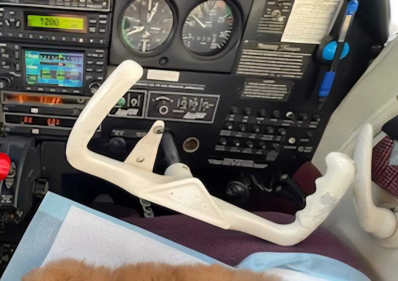

Would a left-side E model yoke (thin/straight) with the opening for the clock work on the right side as well? I am considering picking up a second left-side yoke for use on the right side since it's pre-drilled for the PTT.
This is how the PTT is mounted on my right yoke. It works well, and is similar to the left yoke mounting.
I know most won't want a left-side yoke for the right seat because the PTT would be on the left horn, and the left hand should be used for panel adjustments and throttle/mixture/prop controls. That said, I don't necessarily care about accommodating a right-seat PIC, it's more or less to allow for a right seat to be able to handle comms if necessary. Upgrading to J/201 yokes entails quite a few pricey and hard-to-come-by parts, and the aftermarket Bonanza yokes with adapters are PMA, but the Mooney isn't in the approval listing at the moment.

I added a panel mounted ptt on the right side so that radio works without interfering with flying.

I’ve never had a complaint from a CFI on my right-side PTT switch… lower right side of the panel.
I have an extra left side yoke with PTT similar to Hank's (except it's for the pilot's side with the clock hole) if you need one.
Not required to be, all that's needed is a 337, I've got one of the Cygnet, in my aircraft....
