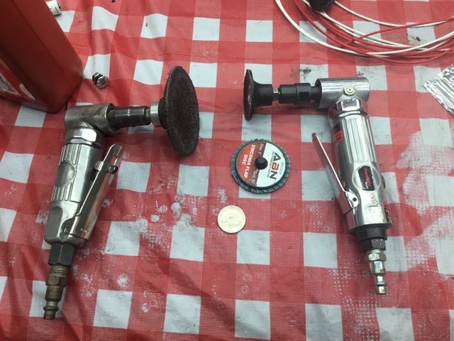

A64Pilot Posted August 25, 2022 Report Posted August 25, 2022 These, they run just as slow as you want, or will scream RPM like, well a dieginder. The one on the right is for 2” pads, pad shown is sanding but meant to show size. They are as gentle as you are and easy to handle especially at lower RPM That’s a quarter for scale

Hank Posted August 26, 2022 Report Posted August 26, 2022 6 minutes ago, N201MKTurbo said: I have said to use 800 grit sand paper and your hand. It will take you a considerable amount of time to make it shiny. Yes, it will take a long time using only 800; I'd start with 320, then 400, 600 and end with 800, with a little oil and wipe the pipe clean between grits. Much quicker, negligee loss of thickness if sanding by hand. Then one XC flight to make the stainless steel pipe start to discolor in the straw-to-brown color. But others here have proposed both electric and pneumatic grinders for polishing the tailpipe. Not on my plane! 6 hours ago, A64Pilot said: Scotch brite pad on an angle die grinder 5 hours ago, A64Pilot said: These, they run just as slow as you want, or will scream RPM like, well a dieginder. The one on the right is for 2” pads, pad shown is sanding but meant to show size. They are as gentle as you are and easy to handle especially at lower RPM That’s a quarter for scale
