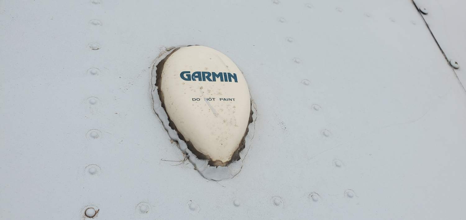

Alan Fox Posted March 5, 2022 Report Posted March 5, 2022 I just look at the antenna , If it is a GA56 , it aint WAAS 1 2

Mcstealth Posted March 6, 2022 Author Report Posted March 6, 2022 On 3/4/2022 at 7:33 PM, Alan Fox said: I just look at the antenna , If it is a GA56 , it aint WAAS Is this the correct one?

Alan Fox Posted March 6, 2022 Report Posted March 6, 2022 7 hours ago, Mcstealth said: Is this the correct one? That is a GA56 , not legal for a WAAS reciever 2 1
