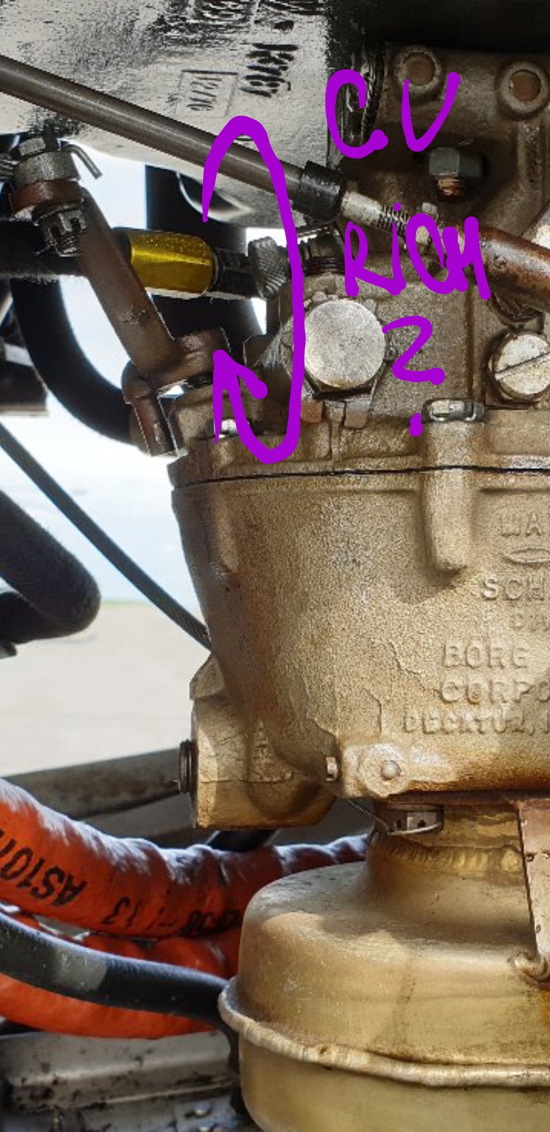

brndiar Posted October 24, 2020 Report Posted October 24, 2020 Please, could anyone explain to me, how do I do the step 3. to 6. in practise? Is a rotation at my second picture correct (toward RICH, step 3)? Apologise for my 1 picture, after uploading unable to rotate. Thanks you in advance, m
Guest Posted October 25, 2020 Report Posted October 25, 2020 With the engine warmed properly, set the throttle to idle around 650-700 RPM, smoothly pull the mixture to ICO. If the mixture is properly adjusted you will see a small momentary rise of 30+/- rpm. A greater rise indicates an overly rich mixture, less or no rise indicates a lean mixture. The idle mixture screw is a fine threaded needle valve, turning clockwise leans the mixture, counter clockwise riches the mixture. Clarence
