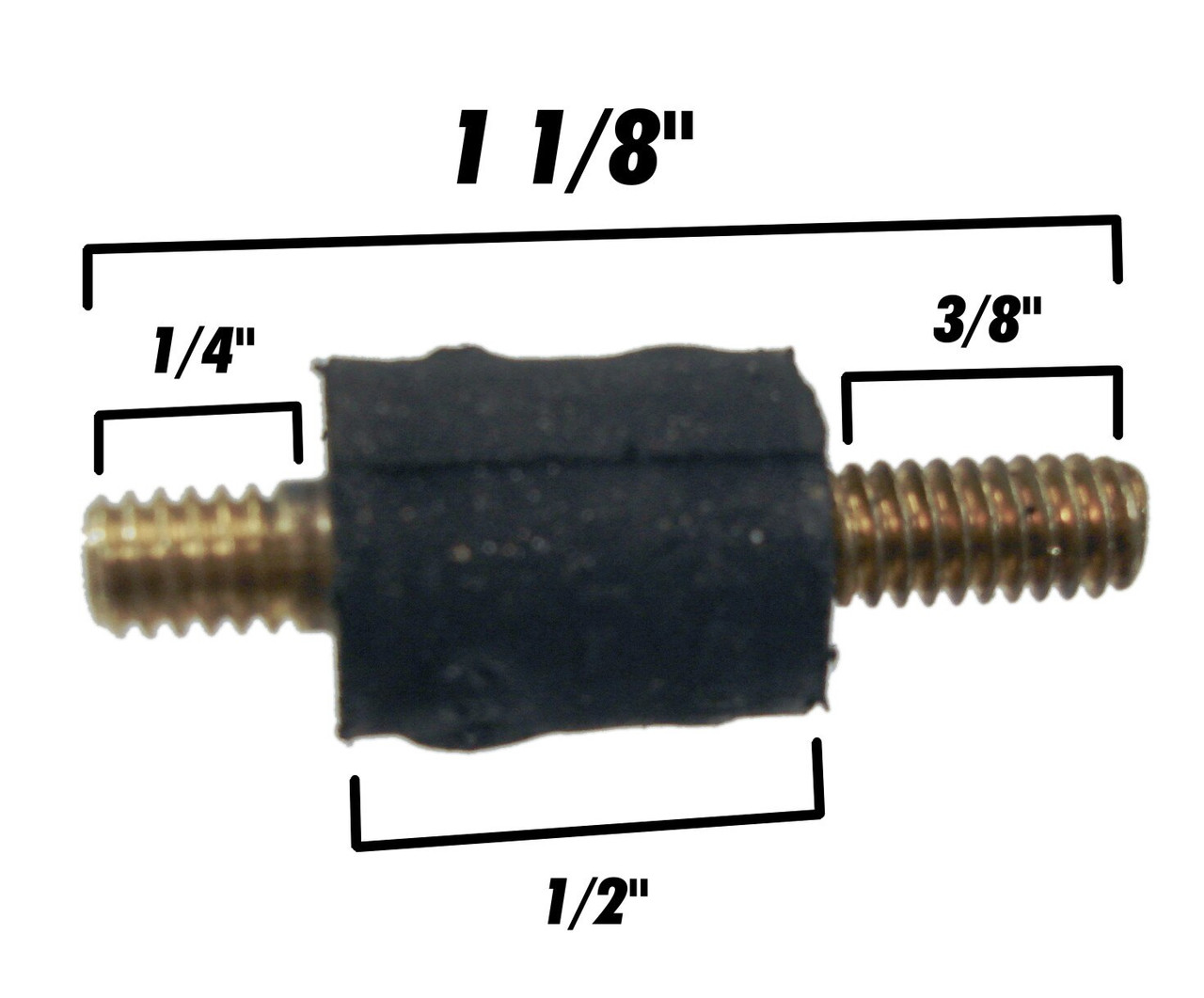

The original shock mounts are made by Lord and about $18 each - brass/nonmagnetic studs I assume specified for the days of magnetic instruments.
Lord J-6984-64 Instrument Panel Shock-Mount at SkyGeek.com The shaft going through the instrument panel is shorter.
SGP118162_1_inset1__30340.1617171021.jpg?c=1
The ones referenced in Aircraft Spruce in are J-6984-1.  They are 1/8 inch too long. (the same length stud on each side)
Overview
Lord round instrument panel shock mount, as used in Cessna aircraft. Overall length 1-1/4". Rubber molded on 8-32 threaded projections. New manufacture.
There is a remedy - you can cut 1/8 inch off one side on each mount.
Aircraft Spruce also has some cheap ones with ferrous studs.
