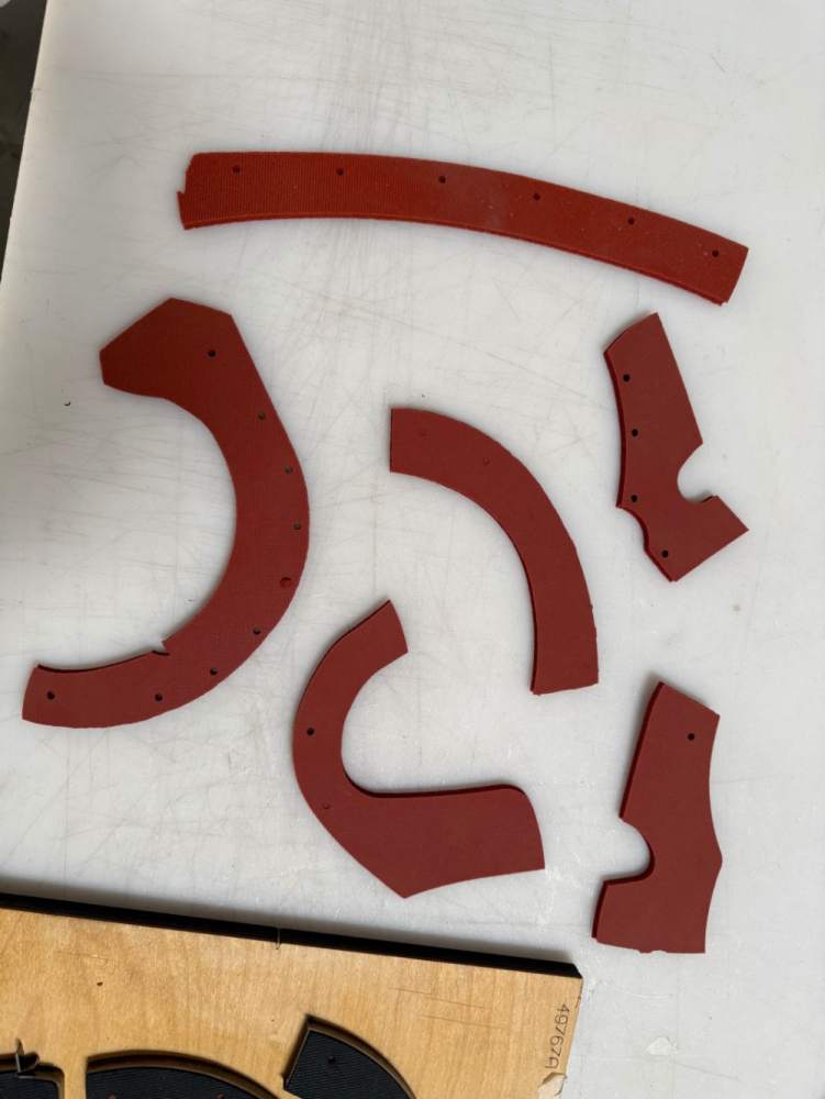

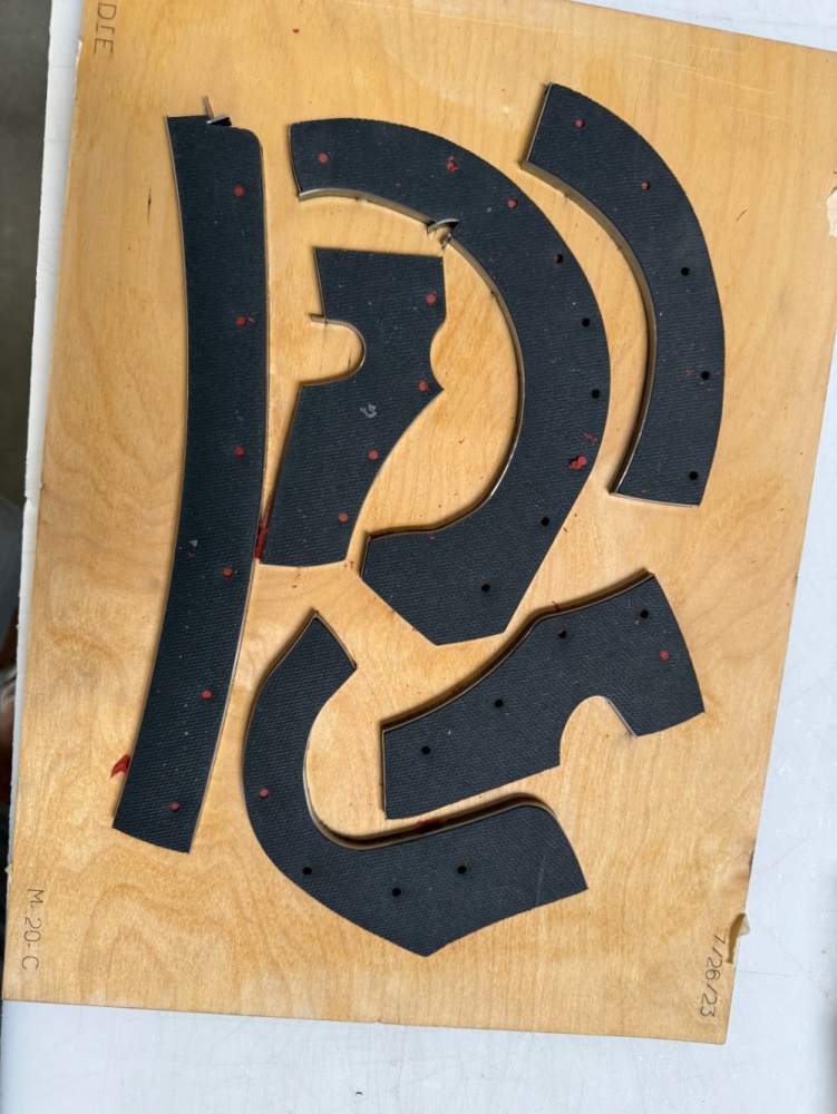

Gee Bee Aeroproducts Posted January 7 Report Posted January 7 There are three baffle seals in ams3320.093 we have from original design. To replace the original felt , we die cut AMS3195-.250 silicone foam This is cemented in place with our two part silicone cement. If you want it correct material let me know.
