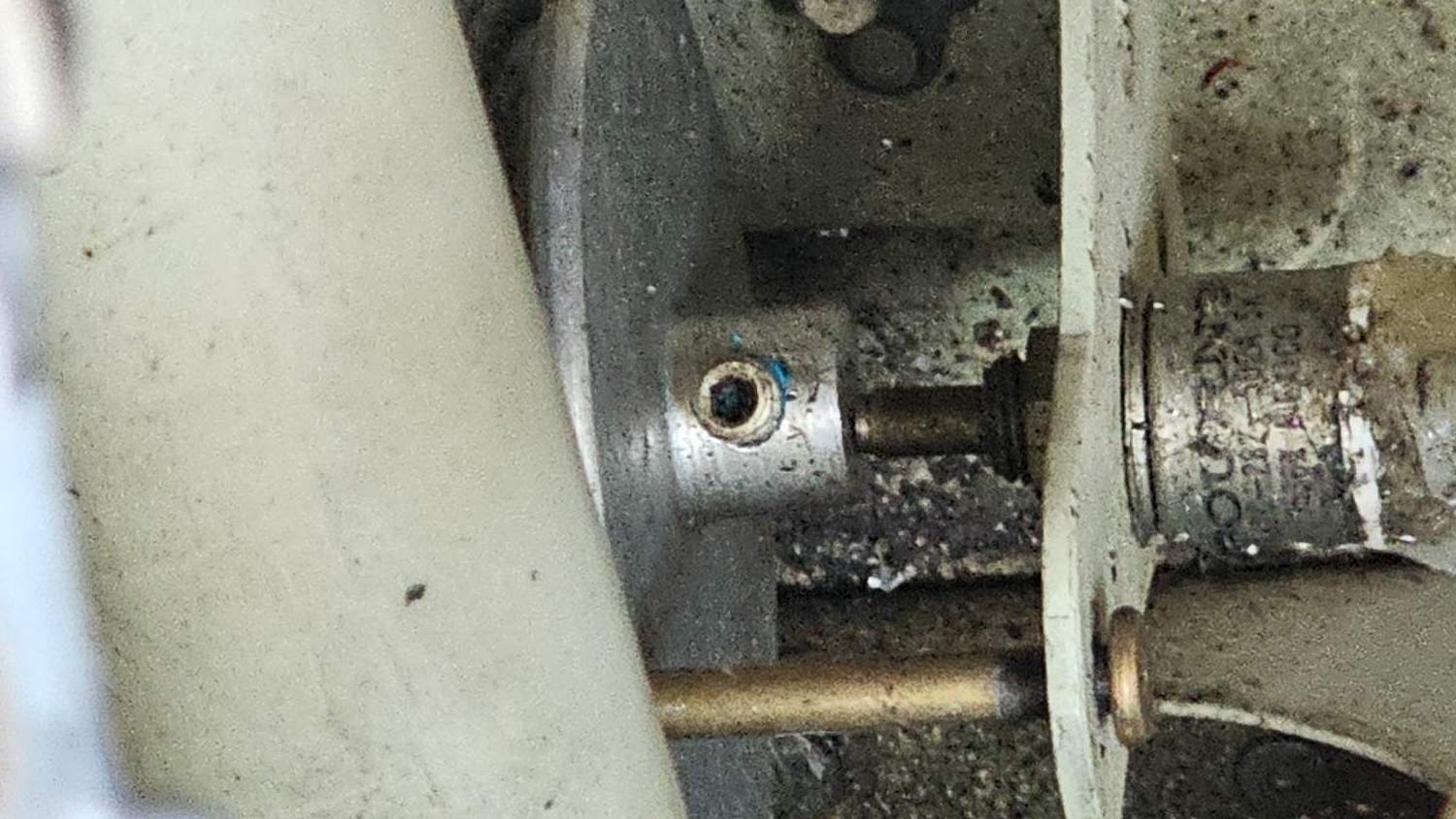

Patrick Horan Posted May 20, 2025 Report Posted May 20, 2025 (edited) Hey guys, when I started up the plane, I tested the rudder trim and I didn't get any indication it was moving. My mechanic came to look at it and he confirmed thst the rudder trim wasnt actually moving. He went to the after service bay and saw that the micro switch in the back was dirty and he cleaned it a bit. Now my rudder is working but the indicator still shows center (it doesn't move). I believe it has something to do with the pentometer but I'm not exactly sure or where that is Edited May 20, 2025 by Patrick Horan

Patrick Horan Posted May 21, 2025 Author Report Posted May 21, 2025 Hey guys, I just checked the back. It looks like the potentiometer is disconnected from that Allen screw. Also, the image is flipped
N201MKTurbo Posted May 21, 2025 Report Posted May 21, 2025 Looks like an easy fix. Just make sure you get them synced. I would adjust the motor for neutral trim, then spin the pot so it indicates neutral trim and hook them back together.
IvanP Posted May 21, 2025 Report Posted May 21, 2025 54 minutes ago, N201MKTurbo said: Looks like an easy fix. Just make sure you get them synced. I would adjust the motor for neutral trim, then spin the pot so it indicates neutral trim and hook them back together. Starting in full deflection to either side may be easier. I am not sure how easy it is to eyeball the "neutral" position of the trim mechanism. Two person job - one in cockpit and one under the plane. The picture makes it look like the pot shaft is not aligned well with the other piece. Did the screw just get lose or is the shaft broken? Maybe it is just the picture, but I would check the setup for excessive slop in it.
Patrick Horan Posted May 21, 2025 Author Report Posted May 21, 2025 35 minutes ago, IvanP said: Starting in full deflection to either side may be easier. I am not sure how easy it is to eyeball the "neutral" position of the trim mechanism. Two person job - one in cockpit and one under the plane. The picture makes it look like the pot shaft is not aligned well with the other piece. Did the screw just get lose or is the shaft broken? Maybe it is just the picture, but I would check the setup for excessive slop in it. That's what I couldn't figure out. It looks like the pententiometer didn't want to go in any further. The shaft might have broken. But I really don't know
Patrick Horan Posted May 21, 2025 Author Report Posted May 21, 2025 50 minutes ago, IvanP said: Starting in full deflection to either side may be easier. I am not sure how easy it is to eyeball the "neutral" position of the trim mechanism. Two person job - one in cockpit and one under the plane. The picture makes it look like the pot shaft is not aligned well with the other piece. Did the screw just get lose or is the shaft broken? Maybe it is just the picture, but I would check the setup for excessive slop in it. Looking at the other ones for sale. The ones for sale all look like they have a longer shaft
IvanP Posted May 22, 2025 Report Posted May 22, 2025 YEs, the shaft is about 1in long if I recall correctly, but that is not necessarily the problem. If you drop the belly pan, you will have better access to the mechanism to see if anything is misaligned or broken. It seems that there is some blue Locktite on the set screw. Try to move it and see if that is the issue or not. Try to run the trim both ways with the belly pan off and observe. 1

dkkim73 Posted May 22, 2025 Report Posted May 22, 2025 17 hours ago, Patrick Horan said: Hey guys, I just checked the back. It looks like the potentiometer is disconnected from that Allen screw. Also, the image is flipped It looks as though that brass colored screw is loose...? Ie rendering those parts father away from each other?
Patrick Horan Posted May 23, 2025 Author Report Posted May 23, 2025 21 hours ago, dkkim73 said: It looks as though that brass colored screw is loose...? Ie rendering those parts father away from each other? Its was pretty tight when I tried to losen it, probably because of the lock tight. Ill look at it soon
