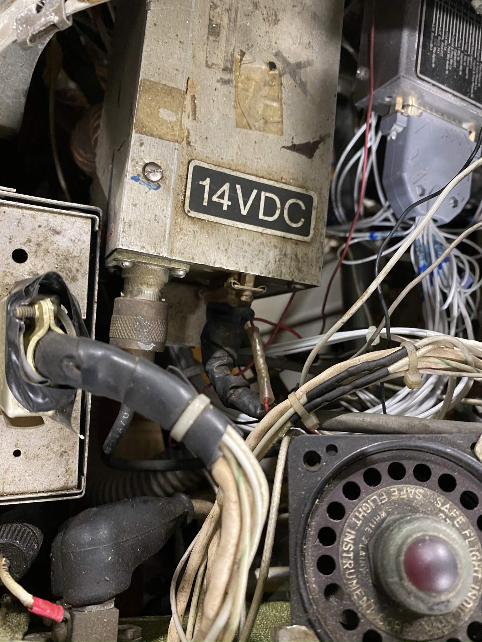

Space behind the right panel is taken over by the big transponder box. It’s gotta go and the EDM fits in the same size hole.

Might need to re weigh and balance the plane after removing this. Anyone need a vintage transponder?  Makes a nice paperweight.

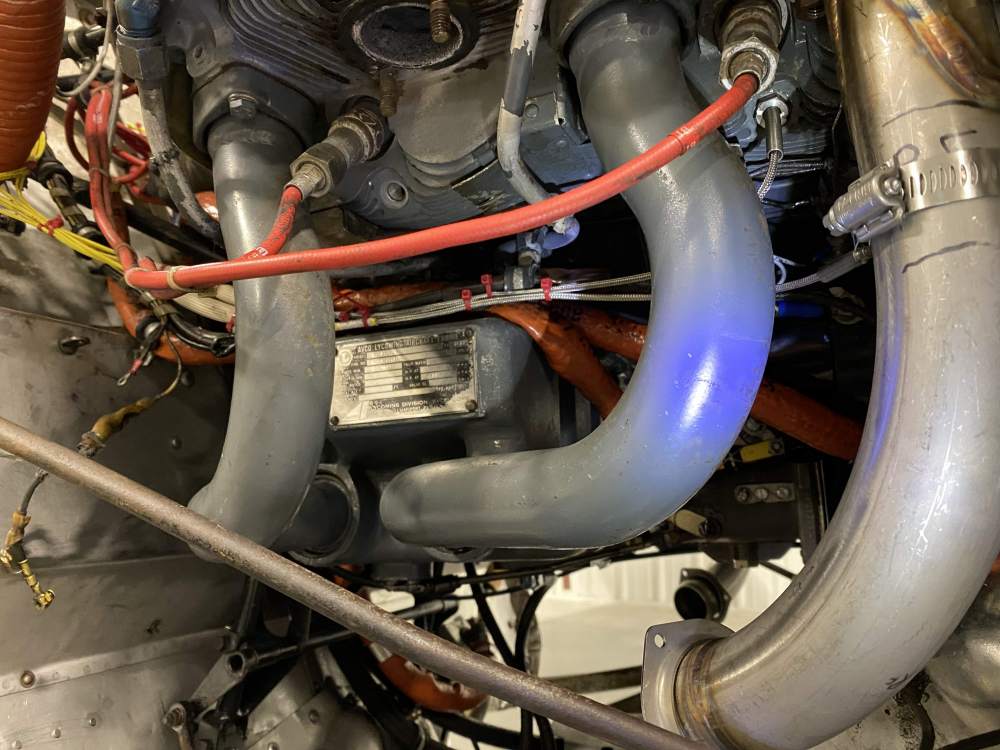

Shot of the wire routing out of two firewall bushings. Right bank out of the lower. Left bank out of the upper.
Shot of the routing. I wanted the EGT inboard so it was cleaner and it could be routed with CHT. Holes are 4” below the exhaust flange. So much time thinking about, and measuring, and double checking this because the new drop tubes weren’t cheap. Lol
Near final right bank routing. It all came together nicely.

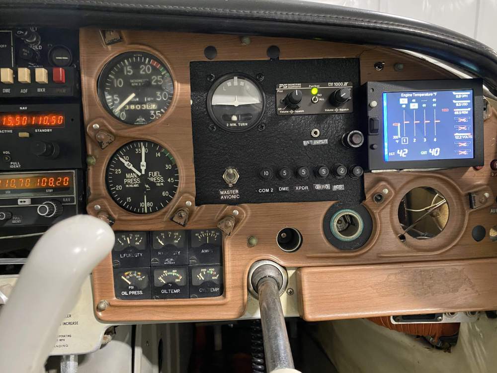

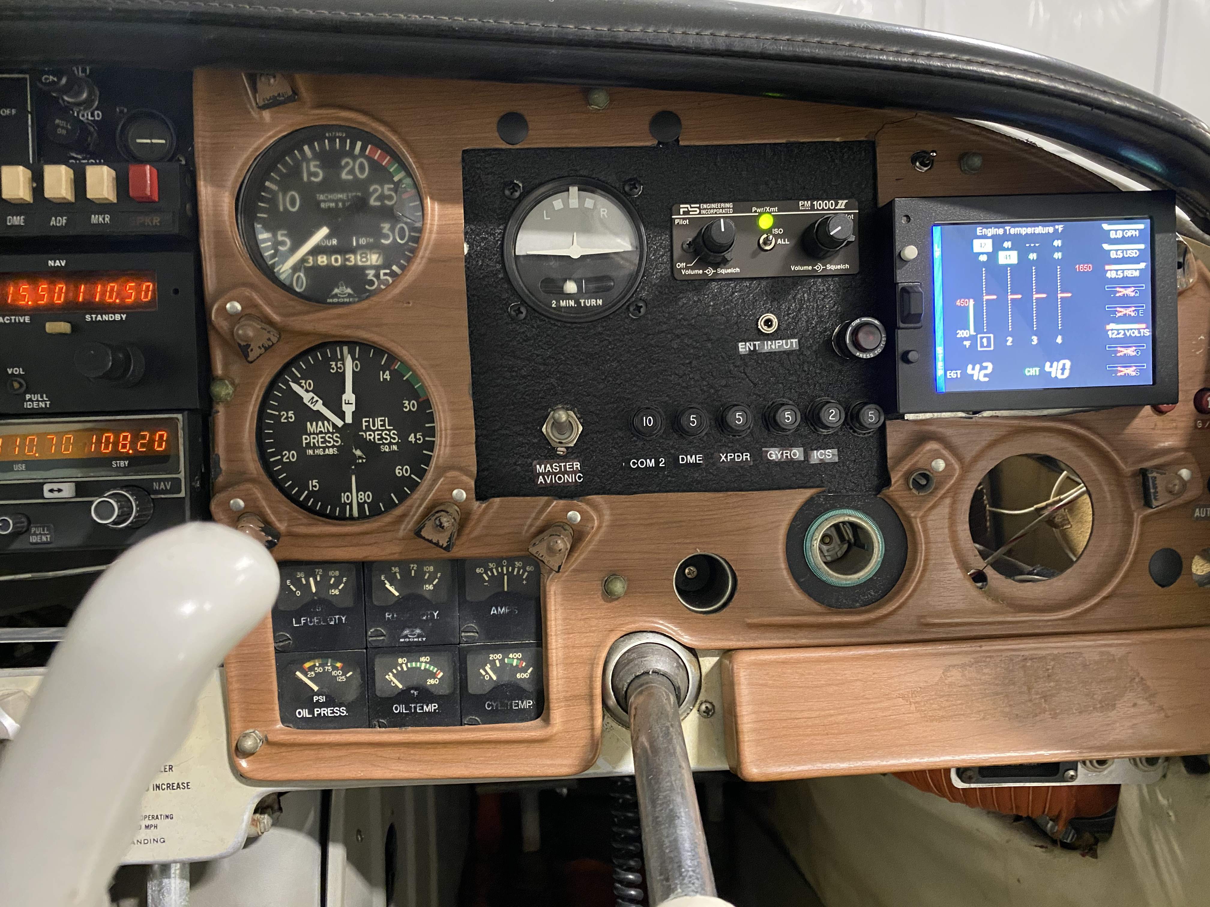

Final install panel shot  It’s not pretty but functional. Hopefully I’ll be able to read it from the pilot seat.  Note the press to test engine warning light installed just to the left of the LCD screen.  To add this you need to put a pin and wire in the the fuel flow serial plug at pin 11.  I didn’t want to mess with the left panel at this time so opted to put it by the instrument itself so it’s obvious what is is for
Getting at the screw that tightens the clamp around the gage is tricky.  Because it has to be done with everything put back in place in my case. Be sure to orient the mount so you can get to it
