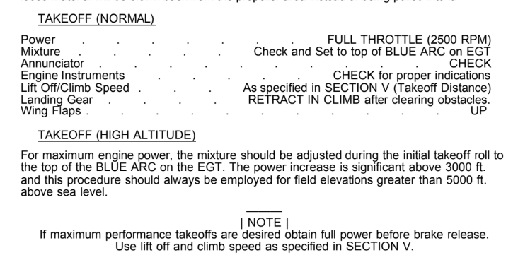

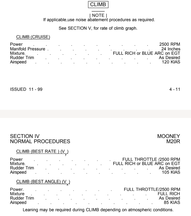

Max Clark Posted November 12, 2025 Author Report Posted November 12, 2025 12 minutes ago, Jackk said: takeoff should always be max available power FWIW my POH has "Check and Set to top of BLUE ARC on EGT" for Takeoff, and "FULL RICH or BLUE ARC on EGT" for Cruise Climb and Vy, and "FULL RICH" for Vx. 2

Jackk Posted November 12, 2025 Report Posted November 12, 2025 59 minutes ago, Max Clark said: FWIW my POH has "Check and Set to top of BLUE ARC on EGT" for Takeoff, and "FULL RICH or BLUE ARC on EGT" for Cruise Climb and Vy, and "FULL RICH" for Vx. Would the blue not be max power? *I have no blue arch
