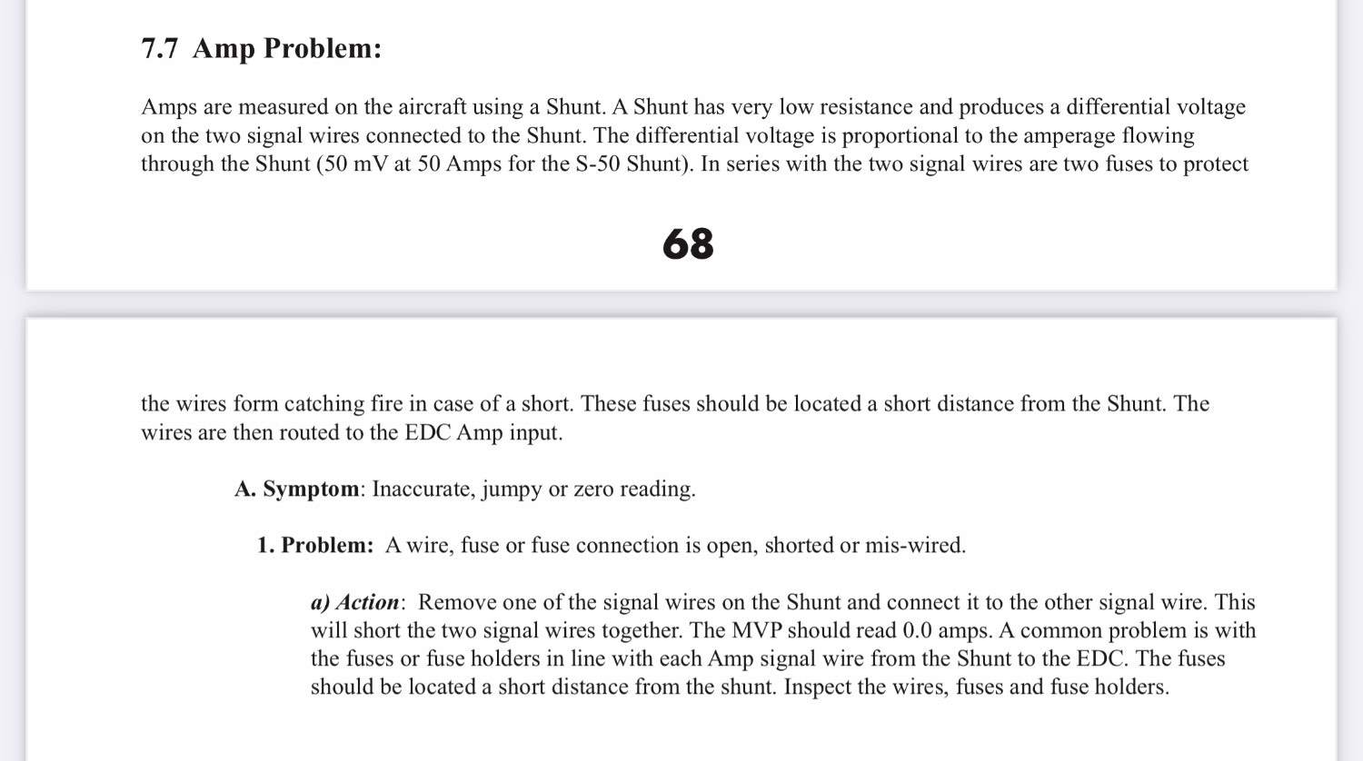

I would carefully check the wiring (and two fuses) to the shunt.  I don't think you are getting a proper differential reading across the shunt.  I believe the wires are white and green per the EI MVP-50 manual.

Jeez, I thought mine was noisy with a +\- 1 or 2 amp wiggle, that looks not right.
Mine does that occasionally. My mechanic cleans/tightens the connections at the master switch and then it's perfectly steady for several months before it goes back to the noisy behaviour.
