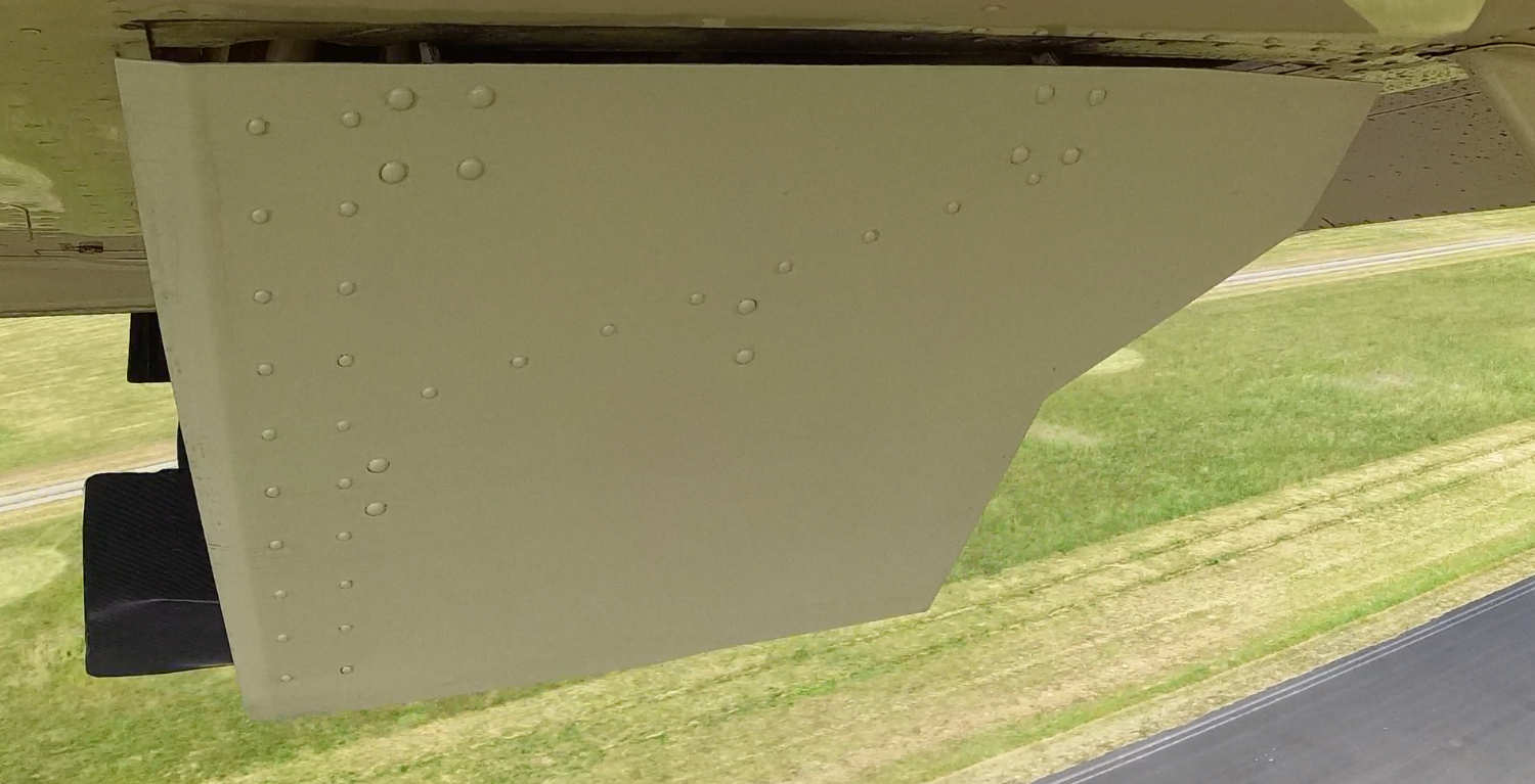

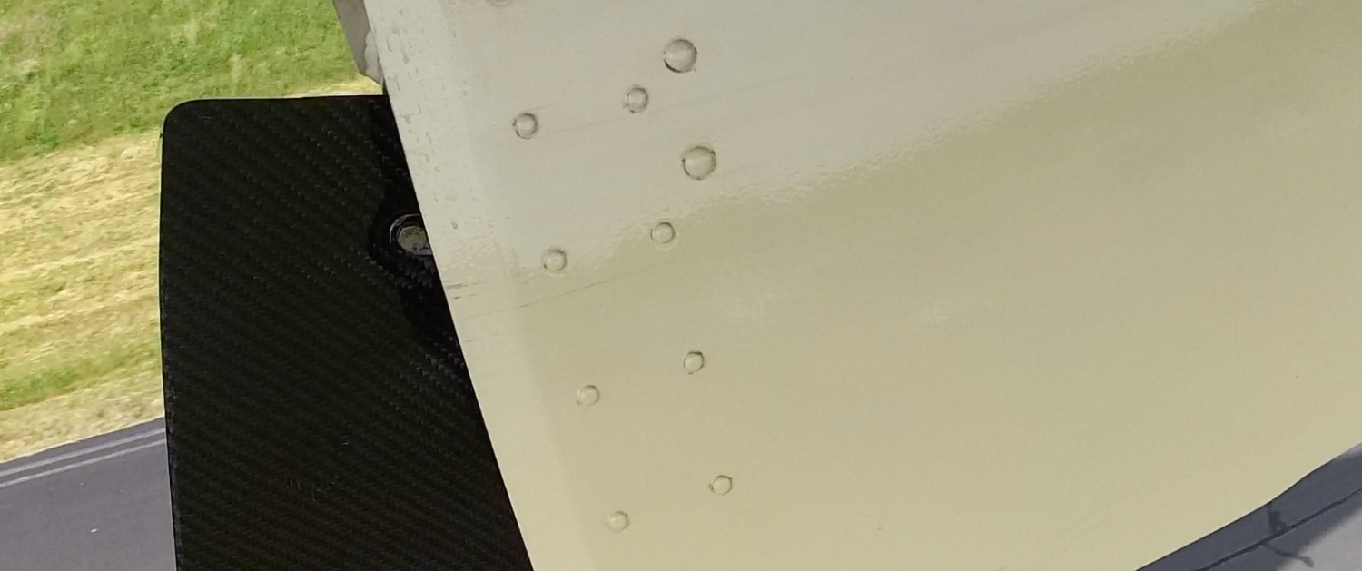

Thanks, A64pilot. I‘ve been thinking about this and there is an excellent video on the topic by the people who build the DarkArrow:
Since the wheel covers are bolted on with steel bolts, all I’ll have to do is making sure no metal-carbon contact exists where the holes are drilled. That can be done by an extra layer of resin.

Thanks for sharing your thoughts. I am now convinced that I underestimated the chafe-problem. So, here is my approach: the contact areas will ALL get an extra resin layer, I will clear-coat the whole part, AND I will add anti-chafe teflon tape. If all goes well, I will be able to install the carbon covers before the summer. I will report here on any galvanic corrosion problems that show up before the end of the year.
In general, I am very grateful for the community discussion here, which can only help to improve the product. My next report will be on the quality of the port-side outer shell after resin infusion.
