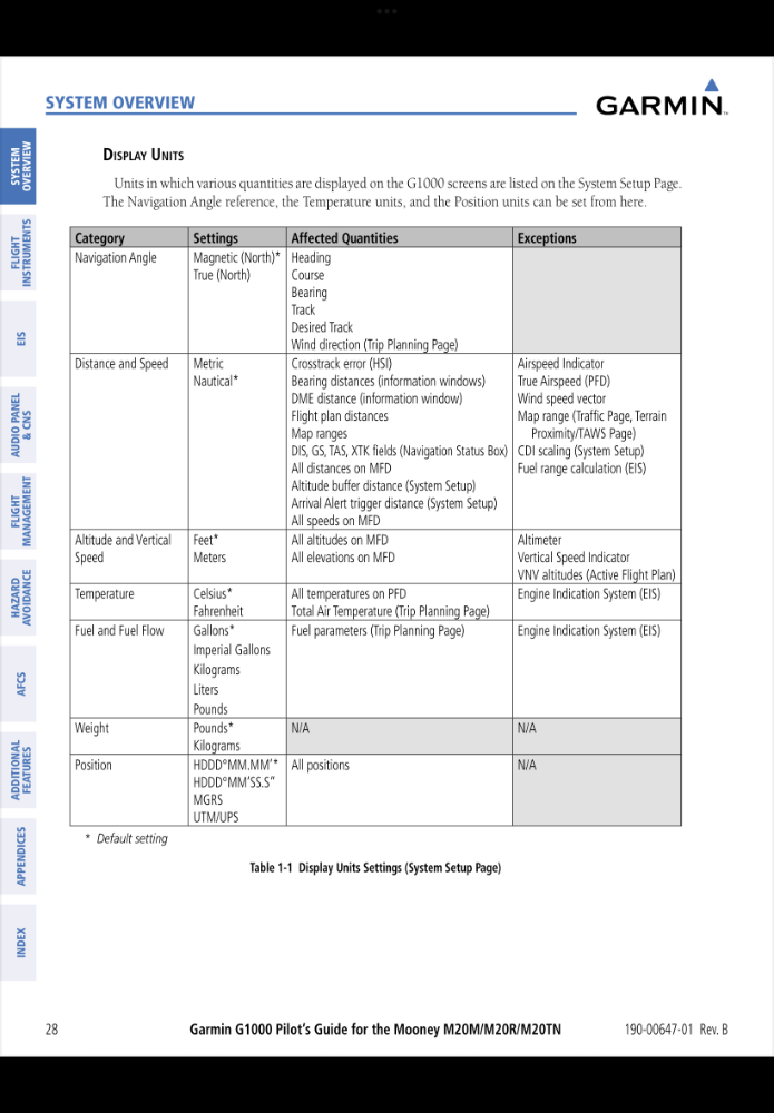

Deb Posted October 18 Report Posted October 18 According to the G1000 Pilot’s Guide for the Mooney M20M/M20R/M20TN, that function is “N/A”: On the PC simulator, the cursor skips the “Position” field in the Display Units box. We don’t know if this is alterable in configuration mode. @PaulM or @Pmaxwell might know. Garmin provides this helpful warning: Warning: Only qualified maintenance personnel should perform this procedure. Improper configuration can lead to system errors. 1
dkkim73 Posted October 20 Author Report Posted October 20 On 10/18/2025 at 3:02 PM, Deb said: On the PC simulator, the cursor skips the “Position” field in the Display Units box. We don’t know if this is alterable in configuration mode. @PaulM or @Pmaxwell might know. Garmin provides this helpful warning: Thanks, Deb! I missed that it was in the manual. I saw the same thing in the PC simulator, and also when I was at Garmin training in Olathe. I'd be curious if it is changeable at a deeper level. Though I don't think decimal minutes is bad for a traditional format, if you ever were working with ground coordination UTM or MGRS would be so much more intuitive.
