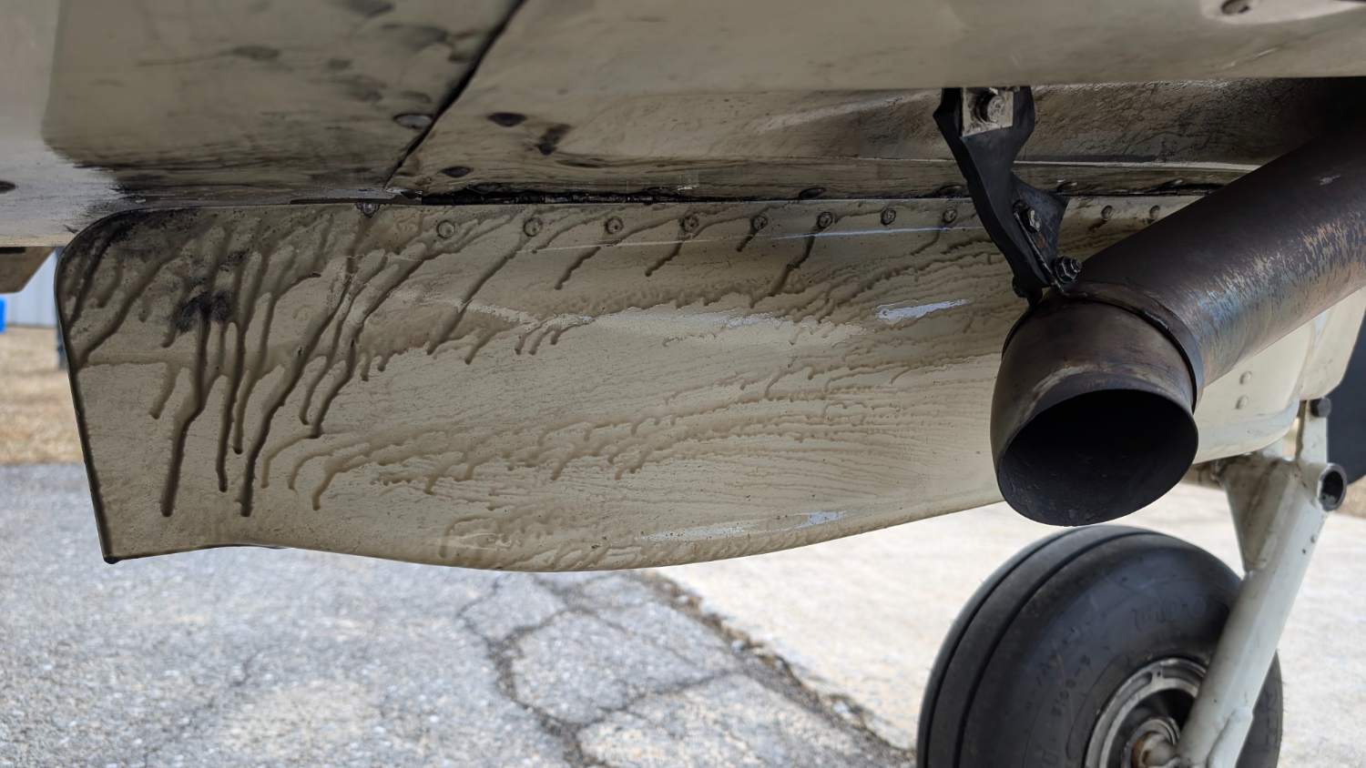

redbaron1982 Posted May 6, 2025 Report Posted May 6, 2025 15 hours ago, anthem4arequiem said: My partner put the oil filter on hand tight and left a note that it needs torqued and safety wired on the annual checklist. This is a no-no for me. Never ever leave something halfway done. Period. Hand-tightening things that are supposed to be torqued, whether it is an oil filter, nut, or whatever, and leaving it like this, is asking for disaster. 7 1
anthem4arequiem Posted May 6, 2025 Author Report Posted May 6, 2025 1 hour ago, redbaron1982 said: This is a no-no for me. Never ever leave something halfway done. Period. Hand-tightening things that are supposed to be torqued, whether it is an oil filter, nut, or whatever, and leaving it like this, is asking for disaster. Absolutely agree. That was a process foul on our side. However, I also think it is a no-no to put safety wire on a filter if you didn't check it. And I am also scratching my head on how the leak wasn't found on the run-up on the ground. According to my A&P, either it didn't leak on the ground because there isn't enough pressure to leak around the gasket, or there was a major oil leak and they just never found the source for sure. But yes. I admit we screwed up with putting on the oil filter.

kortopates Posted May 10, 2025 Report Posted May 10, 2025 (edited) On 5/6/2025 at 9:20 AM, anthem4arequiem said: Absolutely agree. That was a process foul on our side. However, I also think it is a no-no to put safety wire on a filter if you didn't check it. And I am also scratching my head on how the leak wasn't found on the run-up on the ground. According to my A&P, either it didn't leak on the ground because there isn't enough pressure to leak around the gasket, or there was a major oil leak and they just never found the source for sure. But yes. I admit we screwed up with putting on the oil filter. You’d be surprised, at least i was after i rescued an experimental aircraft pilot of his honeymoon no less in Mexico. He flew it down after an oil change without an any leaks, visited a couple airports before it started leaking. He flew to where he was hoping he could limp home but lost a couple quarts in 20 min. You already know what happened but I didn’t know he had done a recent oil change when i started helping him find the source of the oil leak. I really thought that plane wasn't going anywhere for awhile. But i found the source very quickly and when i removed the safety wire i was more than shocked i didn’t need a wrench on the filter to twist it off. So point is it may not be leaking right away even though it will gush oil out pretty soon! Sent from my iPhone using Tapatalk Edited May 10, 2025 by kortopates 1
toto Posted May 10, 2025 Report Posted May 10, 2025 3 hours ago, kortopates said: You’d be surprised, at least i was after i rescued an experimental aircraft pilot of his honeymoon no less in Mexico. He flew it down after an oil change without an any leaks, visited a couple airports before it started leaking. He flew to where i was hoping he could limp home but lost a couple quarts in 20 min. You already know what happened but I didn’t know he had done a recent oil change when i started helping to find the oil leak. But i found the source very quickly and when i removed the safety wire i was more than shocked i didn’t need to a wrench on the filter to twist it off. So point is it may not be leaking right away even though it will gush oil out pretty soon! Sent from my iPhone using Tapatalk Kind of surprised that you found safety wire at all Some of the experimental folks are notorious for skipping the safety wire on oil filters.
