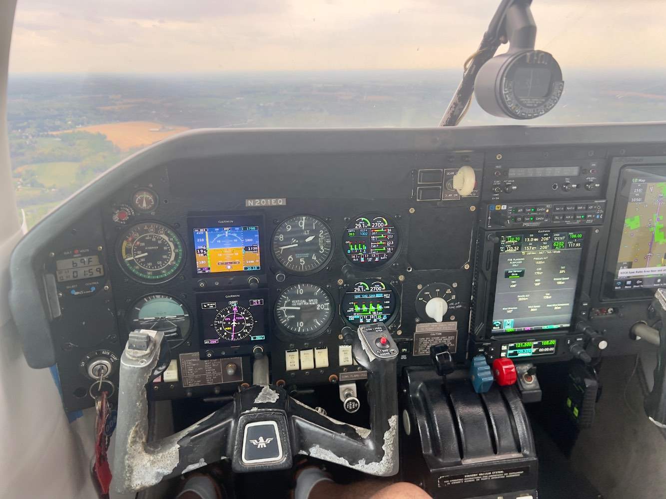

jetdriven Posted April 27, 2025 Report Posted April 27, 2025 General the Mooney airplane is slower the higher you go. It seems to not matter much between 3000 and 7000 feet but it’s definitely slower above that. Here’s a real 203 miles an hour true (176kt) in a J model but look at the altitude.
cliffy Posted April 28, 2025 Report Posted April 28, 2025 49 minutes ago, jetdriven said: General the Mooney airplane is slower the higher you go. It seems to not matter much between 3000 and 7000 feet but it’s definitely slower above that. Here’s a real 203 miles an hour true (176kt) in a J model but look at the altitude. Braggart! :-)
