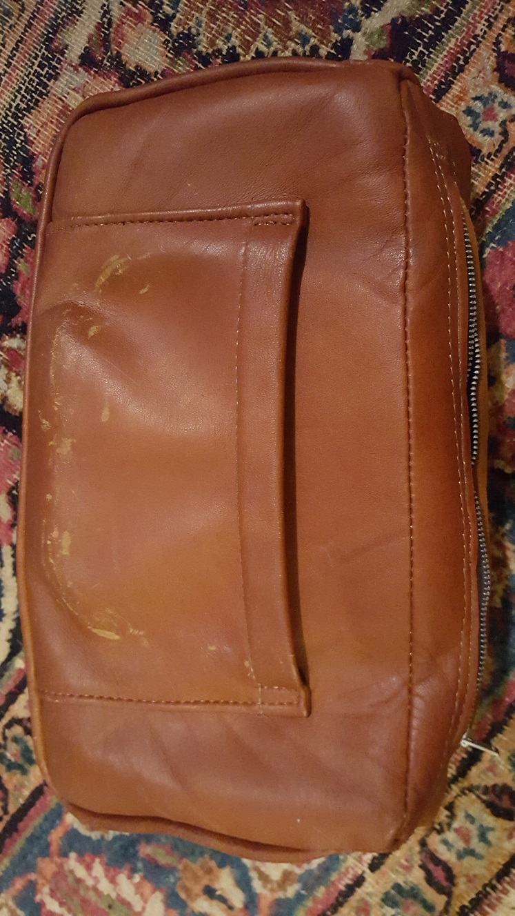

Yetti Posted February 21, 2017 Report Share Posted February 21, 2017 Has it been recovered. I would bet the holes for the head rest are there. Feel around on the top of the back. If they are there you can search for threads on say toyota head rests being the same spacing. Or it is just a piece of tubing with two bends. Then the head rest slips has a pocket that slips over the tubing. Quote Link to comment Share on other sites More sharing options...
75_M20F Posted February 21, 2017 Author Report Share Posted February 21, 2017 31 minutes ago, Yetti said: Has it been recovered. I would bet the holes for the head rest are there. Feel around on the top of the back. If they are there you can search for threads on say toyota head rests being the same spacing. Or it is just a piece of tubing with two bends. Then the head rest slips has a pocket that slips over the tubing. Is that your shaving kit or what? 2 Quote Link to comment Share on other sites More sharing options...
Yetti Posted February 21, 2017 Report Share Posted February 21, 2017 That is an official Mooney head rest cushion from 1975. It is a cube of leather that goes over a cube of foam. The pocket shown in the picture goes over the metal tubing that fits in the seat Quote Link to comment Share on other sites More sharing options...
